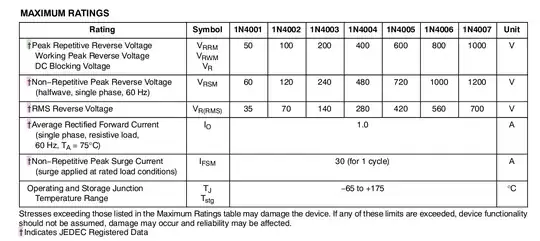

But I recently found a shortcut. It only occasionally works, but it does sometimes provide you some of the information in JEDEC specs without payment, it's not satisfactory at all, but better than none, I guess. The secret is: some manufacturers occasionally cite the original JEDEC specs in their own datasheets. For example, using 1N400X diodes as an example, if we take a look at ON Semiconductor's datasheet, we see a small footnote:
† Indicates JEDEC Registered Data
And if we review the datasheet again, looking for the "cross" symbol...
Maximum Ratings
So, in this table, all the data listed in Peak Repetitive Reverse Voltage, Non−Repetitive Peak Reverse Voltage, RMS Reverse Voltage, Average Rectified Forward Current, and Non−Repetitive Peak Surge Current came from the original JEDEC specs of the 1N400X diodes.

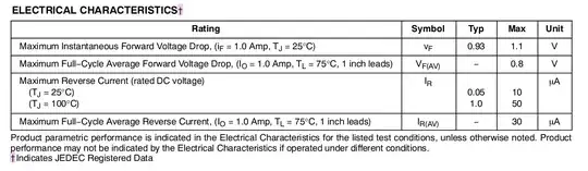

Electrical Characteristics
So we can assume that everything listed in Electrical Characteristics is data from the original JEDEC spec as well. But be careful here: all the parameters listed here are maximum ratings, thus only the MAXIMUM values given here are valid JEDEC specs, not TYPICAL values. To verify this fact, I paid to get the original JEDEC spec and crosschecked it.
