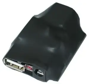

This is not an answer on why this might be happening, but rather how you might mitigate it.
To handle ground-loop problems with a USB peripheral, you can get a USB Isolator like this one for $37.75:
I haven't used this particular device. There are others, like this one but I have no price information (they have a phone number to reauest a quote, which may mean they only sell in bulk).
