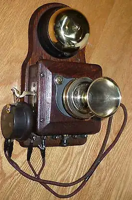

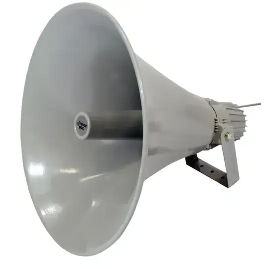

The funnel you're supposed to yell into is actually a horn:
Horns are acoustic transformers, they are usually used the other way around: a high-pressure transducer ("compression driver") is mounted on the throat, and the horn outputs a low-pressure acoustic wave on the other end with a much larger surface area, which results in high acoustic power. Basically a megaphone:
But they work both ways. When mounted on a microphone, the whole surface area of the "mouth" of the horn is used to input acoustic waves, and at the other end it outputs much higher pressure, which increases the signal available to the primitive microphones of the day...
This is not amplification as it is purely passive, but I'm sure it helped.
Note: horns also distort due to internal reflections and resonance modes, which is why they usually sound a bit "honky".

    But they work both ways - Plugin your earphones into your microphone jack, fire up a sound recorder and see for yourself. Disclaimer: May involve yelling to get satisfactory results. – Tejas Kale Oct 03 '17 at 20:13
  • Audio devices are transducers - so like antennas can indeed work both ways. One thing I would add is how hearing aids concentrate sound in the same way the microphone horns on the old phones. Of course it is all done with electronics now. But I always crack up when I see old photos of the elderly men holding up big horns to their ears, saying, "Eh?" – SDsolar Oct 10 '17 at 03:50

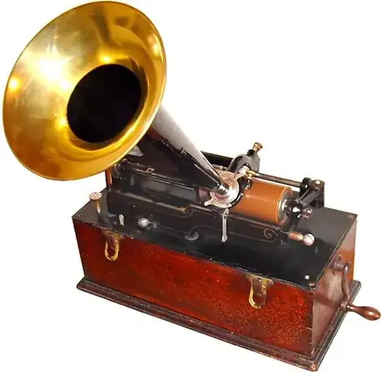

Before vacuum tubes and transistor amplification, most amplification of sound was done at acoustical level, by means of exponential horns. The amplification occurs by means of creating directional sound, and better match between acoustic impedance of open air and transducer membrane. One simplest example of this technique is to hold both palms around your mouth when shouting into public, or use of a paper cone.
A better design was the Edison Phonograph, wikipedia.
