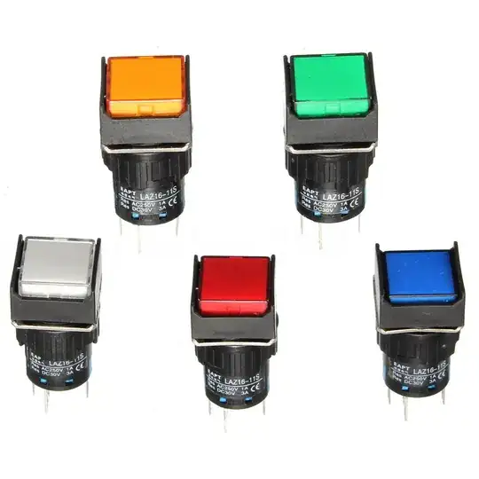

I am trying to control a 12V and 24V LED inside a push button like the one below.
I have tried with transistors and today with mosfets.
Problem: I cant make the LED fully turn OFF and ON as it would when applying directly the 12V or 24V power source to the LED directly.
(I have two versions of the pushbutton LED, 12V and 24V and I would like to learn how to design the different circuit for each to control them)

These are the buttons: enter image description here

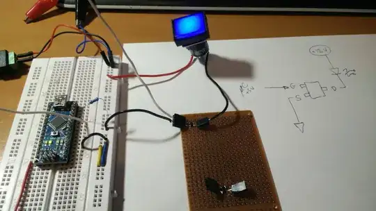

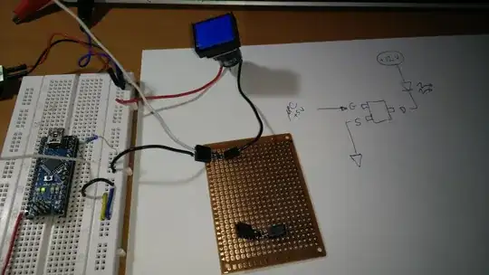

See my setup in the picture attached. After a fresh start with a new mosfet, new wiring and clean table it works! I believe the problem was:
  • The mosfet Drain and Source were connected as P-Ch so I had it the wrong way, and eventhough I reversed it, I damaged it. All tests after this were useless.
  • At some point I connected the mosfet the right way, however as the part was damaged I did not see any difference which confused me even more.
I need to check now with another smd n-ch mosfet that has a Vds of more that 24V.
btw, the code was ok (just blink LED sketch). ;)
Some pictures for anyone who might need help in a similar situation. The power supply on the top left dc jack is supplying 12V. The consumption is around 20mA which are mainly due to the Arduino Nano running the blink example sketch.
Serge
