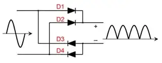

Example 1: Consider the output of a bridge rectifier.
Obviously the input here is AC, but what do we call the output.
If we are going to use it for the regular function to generate a DC power source, we call it DC, despite the fact it is really an AC function with a DC component.
If however we intended to feed that full rectified wave into an amplifier as a signal we would call it an AC signal.

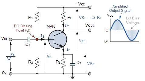

Example 2: Consider a simple DC biased amplifier
Again the input is obviously classical AC, but in order to function correctly, a DC voltage component is added and the output ends up with a DC component of Q. However we would still call the output an AC signal despite the bias.
In fact this still holds true even if the input signal is removed. On the scope the output may look like a DC voltage, but we would refer to it as a zero amplitude (biased) AC signal.

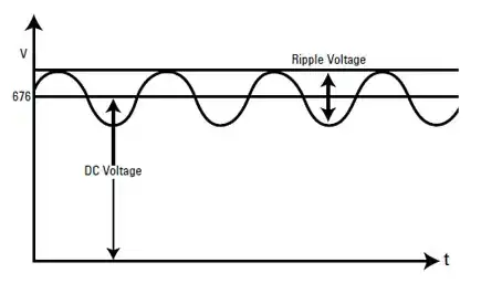

Example 3: Is it AC or DC?
You could call this waveform a DC voltage with a ripple, or you could call it an AC voltage with a large DC offset.
Either could be correct. Which one is more correct depends entirely on how the signal is being used. In some applications, both could even be true.
