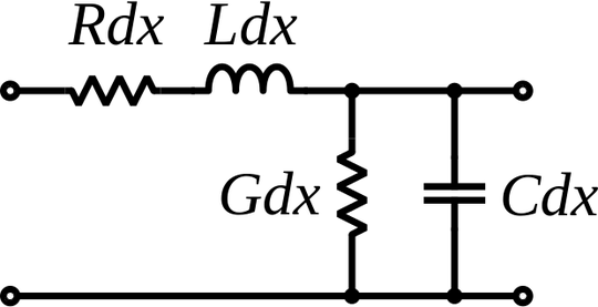

The characteristic impedance of a transmission line is the ratio of the voltage and current of a wave that can travel along the line without distortion. If you tried to inject a signal with a different ratio of voltage to current, you'd find that part of the injected signal travels one way on the line and the other part travels the other way --- you'd create a reflection.
Since this property of the line --- the type of wave that can travel along it without distortion --- is specified by a ratio of voltage to current, we can give it a value in ohms, and call it an "impedance". But just like the gain of a current-to-voltage amplifier, that doesn't mean it has any other behavior in common with a resistor, and you shouldn't expect it to.

Distributed RLC is a per-unit-length variable which depends on track width and thickness-to-gap ratio to ground and dielectric e, which determines Zo.
  • minor changes occur due to conductivity and skin effects, but
Since RLC values are distributed, and impedance depends on ratios, length has no effect on Zo, but it does affect attenuation.
When there is a mismatched load and ω, the propagation delay is less than the rise time. The result is overshoot and when mismatched at the source, another reflection occurs which results in the classic dampened ring waveform at half cycle corresponding to this propagation delay time.
Inductance increases with lower track width to gap times length, while capacitance increases with conductor area to gap ratio times length.
  • Thus the impedance input and output of this transmission line Enter image description here becomes the ratio of \$Z_o=\sqrt{\frac{R+\omega L}{G+\omega C}}\$ which at high ω or small x, you can neglect R and G, and at DC you can neglect L and C.
  • If Zo is much lower than the load then C dominates the response with a fixed source resistance.
  • When Zo is higher than the load, then L dominates the response.
The math proof for the above exists, but it is not shown for the sake of brevity.
