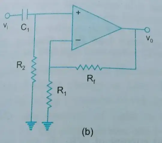

I read somewhere that the addition of R2 provides the DC return to ground however this would reduce the overall input impedance of the op-amp. Input impedance must be high for an op-amp. How to solve this problem? hand-drawn circuit diagram of amplifier with R and C on input

  • I have attached a figure now. – Shivam suhane Sep 27 '17 at 19:23

The opamp input pins have a small bias current. Without R2 in your example the capacitor would gradually charge up or down eventually bringing the pin to V+ or V- and the circuit would no longer work as intended.
I have read somewhere that R2 added provides the dc return to ground however this would reduces the overall input impedance of op-apm.
Yes, so it is important to understand the effect on the circuit.
I/p impedance must be high for op-amp.How to solve this problem?

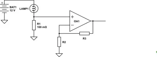

Not quite right. The op-amp's input impedance is high by design. It will have no objection to being connected to quite a low resistance. For example, if the op-amp is used to measure the voltage drop across a current shunt the resistance might be << 1 Ω.
schematic
Figure 1. R1 allows OA1 to measure the current through R1, a 0.1 Ω current shunt.

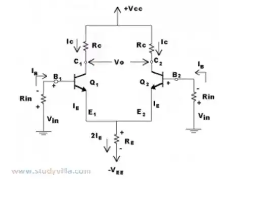

The inputs of an op-amp must have a DC path for the bias currents to flow.
You can see in the bipolar op-amp input stage example below that there must be continuous base current flowing:
A continuous current into a capacitor will cause the cap voltage to ramp until it hits some saturation limit, so without a DC path you will likely rail your input.

Why does a resistance is added along with capacitor to block dc component of input voltage in of non inverting ac opamp?
The inputs of an op-amp must have a DC path to allow bias currents to flow and to set the desired DC operating point. If you don't provide a DC path then the likely outcome is that the DC input voltage will drift out of the acceptable common mode input range and your amplifier will not work.
You have two main options. Each has downsides.
  1. Use a larger resistor. The downside here is that increasing the resistance will increase the output error caused by aplifying the bias current.
  2. Make the first stage of your amplifier chain DC coupled. The downside here is that DC bias current will be drawn from your external source (and if it can't be drawn you are back to your original problem)
Choosing the right op-amp can help a lot. For example the LTC1052 has an input bias current of 30pA max. So even with a 1GΩ input resistor the bias current would only give you 30 mV max of input voltage error (output error will depend on gain).

Indeed, it is important that the input resistor provides a DC return path so that the bias current will not end up charging the capacitor, which will thereby displace the voltage at the (+) input out of the op-amp's range.
However, another role of the resistor is that it nails down a concrete input impedance that is independent of the choice of op-amp. If we instantiate \$R_1\$ as a \$10\text{k}\Omega\$ resistance, then basically that value is the input impedance of the input. (Based on the hypothesis that the input impedance of the op-amp input \$R_\text{big}\$ is so high that \$R_\text{big} || R_1 \approx R_1\$: we say that the value of \$R_1\$ "swamps" (overpowers) \$R_\text{big}\$.
If we don't nail down a concrete input impedance for the input stage, then the input stage is at the mercy of the specific op-amp part. It could be a million ohms, ten million, hundred million: orders of magnitude variations.
One small problem might be that the impedance is unnecessarily high. Perhaps the circuit driving the stage has minimum load requirements; there are such circuits.
The variation in impedance means that the RC product of the impedance and our coupling capacitor C is an unknown. That's a problem because the input stage constitutes a high-pass filter; if we don't know the impedance behind the capacitor, we don't know what is the knee frequency of this filter.
By designing in the input resistor and capacitor with specific values, we get predictable behavior that we justify with respect to the requirements for the circuit, and which won't change with variations in the op-amp part.
