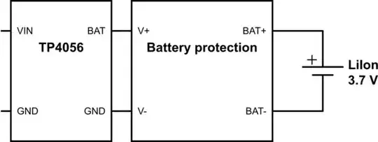

I think you should simply do what everyone else does and that is simply this:
schematic
This is how it is supposed to be used!
The overcharge protection of the DW01A is not the same as what the TP4056 has! You want both. The TP4056 charges until the battery is full and then it stops charging. The DW01A's protection is there to prevent fire/smoke when the TP4056 does not stop charging (for whatever reason). Some cheap Chinese gadgets rely on the DW01A to stop the charging but actually that's a really bad idea. The DW01A stops the charging at a much higher voltage than any decent charger. So the battery will be overcharged all the time and wear out more quickly.
