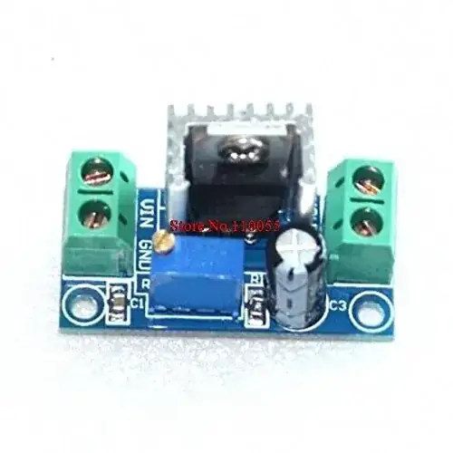

There are very cheap and easy to use voltage regulator modules available on Ebay for like $ 1 each, I suggest you get two of those.
This is the (LM317 based) module I'm talking about: enter image description here

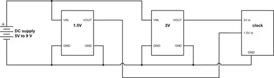

Then connect them like this:
schematic
You should use a DC adapter of at least 5 V so you could use a USB phone charger. I would not go higher than a 12 V input voltage.
Before you connect the clock, use the small screw on the blue variable resistor to set the output voltage to 1.5 V and 3 V.

Also the cost of the individual components to make that will not be less than just buying two modules. We EEs often have these components in our part drawer so for us they're "free" but since my guess is that you would have to buy everything, it might be easier to just get two cheap LM317 based regulator modules.

  • This seems like a very economical solution (LMC317) that would end up as a clean installation. I appreciate the help with this! :) – Jim Ondracek Sep 23 '17 at 09:27
