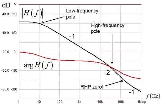

Why would it be different for the frequency response of an amplifier or a power converter? If I take the following transfer function \$H(s)=H_0\frac{(1-\frac{s}{\omega_{z1}})(1+\frac{s}{\omega_{z2}})}{(1+\frac{s}{\omega_{p1}})(1+\frac{s}{\omega_{p2}})}\$ which is the transfer function of a boost converter operated in the discontinuous conduction mode (DCM), the frequency response is below:
You can clearly see a gain in dc (\$H_0\$) then the effect of the poles and zeros. You realize the action of the right-half-plane zero (RHPZ) which brakes the -2 slope (-40 dB/dec) into a -1 slope (-20 dB/dec) but keeps lagging the phase at high frequency.

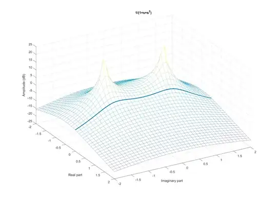

The answer is actually that the position of the pole heavily influences the transfer function. Poles can be anywhere on the complex plane. And if you get close to those poles (on the complex plane), then you will indeed see that you will get to infinity there.
However, a bode plot, transfer function or anything similar doesn't cover that whole complex plane. It will stay on the imaginary axis! And so unless your poles are exactly on the imaginary axis, you won't see any point going to infinity.
The following figure illustrates this with the transfer function:
\$TF(s)=\frac{1}{1+s+s^2}\$
Amplitude in dB of 1/(1+s+s^2) in the complex plane
The bold line is the frequency axis that you use for bode plots or transfer functions. But you see that it "misses" the poles completely.

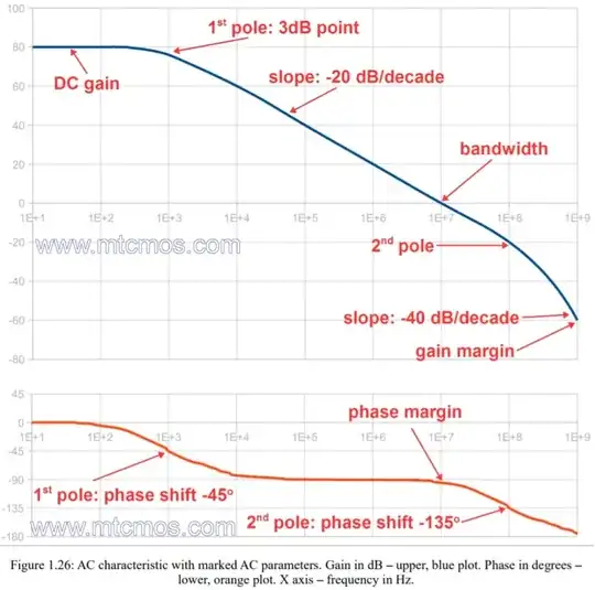

Maybe that would help you:
AC characteristic of an opamp
Source: https://payhip.com/b/5Srt
