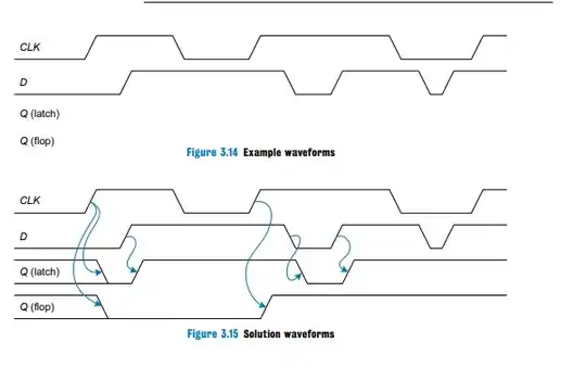

To understand the difference between a latch and a flip-flop. let us take up the example of D-latch and D-flip-flop. In D-Latch D value copies to Q whenever the clk value is 1. In D-flip-flop D copies to Q only on a rising positive clk edge, i.e. Q will be D only when the clk value changes from 0 to 1; the D-flip-flop maintains the previous state irrespective of D value in all other cases. Difference between latch and flip flop using timing diagram
  • M SAI NITHIN - Hi, Please note that when a post copies or adapts material (e.g. text, image, photo etc.) from elsewhere, that content must be correctly referenced. For online content, the source webpage / PDF / video etc. should be named & linked as a minimum (see the rule about references for offline books / articles). Therefore please [edit] your answer to add the appropriate source reference (source name & link) for that diagram & remember to include references in future. Thanks. || As you're new here, please see the main site rules in the [tour] & [help]. – SamGibson Dec 06 '23 at 03:21
