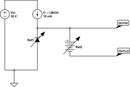

However, I'm trying to generate the DC input voltages for testing purposes, and while generating a baseline is easy (I can build a variable reference around a TL431, a LM334, and a pot), how can I go about generating a voltage that is X volts below it, for user-variable (via a pot) values of X (I can accept a range for X from say 1 to 10 V), in a simple way? Output currents can be on the order of a couple of milliamps, as all this will be hooked to is an op-amp circuit's inputs, and the voltage accuracy doesn't need to be great either (if I can get within 5% or so at room temperature, I'll be fine). See the behavioral schematic below.
schematic
The easiest way to handle this I can come up with uses an op-amp differential amplifier to subtract the output of a second variable reference from the first, but it seems to me like there should be a simpler way to do this...

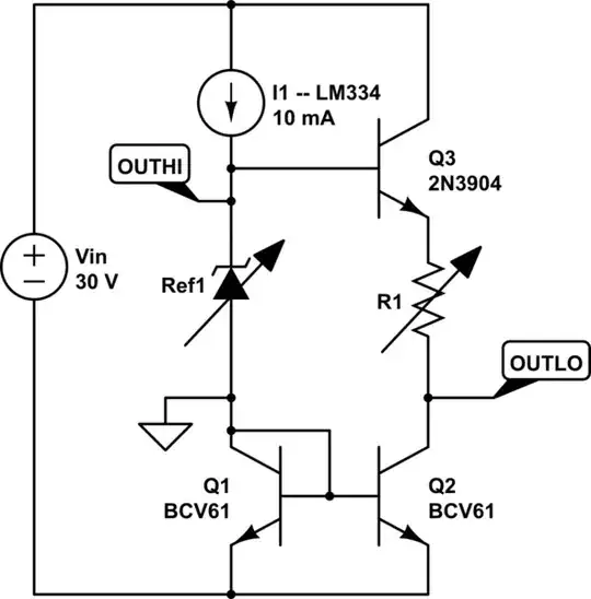

Ah, heck. I'll just draw the behavioral thing for you, below. Worst case you tell me all kinds of reasons why it won't help you. But either way, perhaps it helps you think of your own solution?
schematic
I tacked a current mirror underneath your reference. I'm suggesting BCV61 here (\$V_{BE}\$ matching), though if you have more money you can also use BCM61 instead (both \$V_{BE}\$ and \$\beta\$ matching.)
If you are cheap or just want to hack it then you can just use PN2222A or 2N3904 devices and add emitter degeneration (to improve \$V_{BE}\$ matching) and a \$\beta\$-compensation resistor (to improve \$\beta\$ matching, of course.) Or play with measuring a few until you get a semi-match.
\$Q_3\$ just lightens the load on your OUTHI and hauls up and down on the emitter. (You could go "Darlington" on this, if you want to seriously lighten the load.) \$R_1\$ drops some fixed voltage based upon your resistance setting for it and the mirrored \$10\:\textrm{mA}\$, so the voltage at OUTLO will be one \$V_{BE}\$, plus this resistor drop, below OUTHI. If you want the range of say \$10\:\textrm{V}\$ to play with, then \$R_1=1\:\textrm{k}\Omega\$.
Be aware of where the ground reference is located. If that's annoying for some reason then it's not hard to move things around and add a part to this.
At least this gets one idea across about level shifting that isn't too involved and isn't difficult to follow. I also think you can play with the basic idea on your own to make it fit better if you want.
