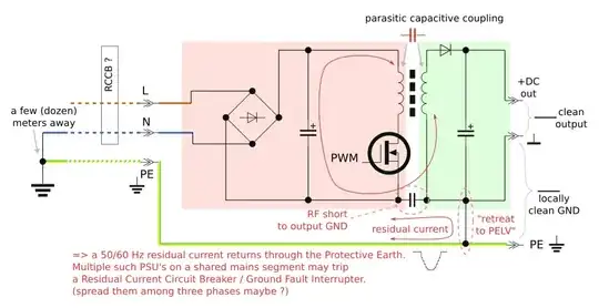

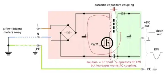

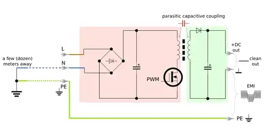

That's simple. It's an inherent downside of switch-mode power supplies. I'd assume yours doesn't have an earth (PE) terminal into the wall.
This is what it would look like without countermeasures: SMPS without RF EMI suppression
This is where you are now, probably: SMPS with an RF short between primary and secondary
This can be done, but it would take a PE terminal on your PSU: SMPS with an RF short between primary and secondary and a secondary - earthed (And it has residual side-effects still: can contribute to a ground loop, can help trip a "Residual Current Circuit Breaker" etc.)
