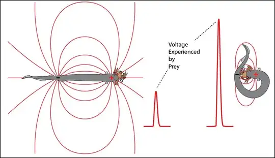

Electric eels tend to curl around the prey when hunting (and shock the predators when these make contact), so the shortest path for the discharge may well be though the prey's body rather than surrounding water.
Source: phys.org Credit: Kenneth Catania
Additionally, electric eels are fresh water animals, so your assumption about water being more conductive doesn't really hold. Blood and lymph are better conductors thanks to the ions (mainly Na\$^+\$ and Cl\$^-\$) present in them. In the end, a significant portion of the current will go through the body, which is enough to stun the prey or scare away predators.

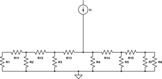

Because the water is not a superconductor. You can model a sea water as a ladder of resistors put in parallel from/to infinity. Now if you apply the voltage difference between two points, the majority of the current will pass at the shortest way, the remaining arround. But exactly how much is a function of the resistance/conductivity of the water. More conductive, then the current cone to the sea bottom would be narrower. Less conductive water, then the current spread would be wider.
