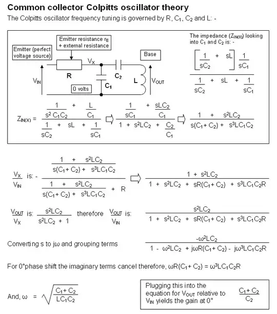

The "basic" colpitts oscillator produces a frequency that is \$\dfrac{1}{2\pi\sqrt{LC}}\$ where C is the net combination of C1 and C2. This would mean that C = 50 pF hence the oscillation frequency will be 22.5 MHz.
The combination of C4, C6 and C8 will lower this frequency possibly sub 20 MHz.
Next is the BJT - it has a transition frequency of only 250 MHz and could easily add 2 or 3 ns delay to the emitter signal. This type of circuit is basically a phase shift oscillator - rarely does the oscillation frequency closely approach the peaking frequency defined by L2 and C1 (not C2). So, given that it is phase shift oscillator, the 2 or 3 ns added around the loop directly equates to a phase angle "add-in" of about 18 degrees and the oscillator will be forced to run significantly slower than 20 MHz.
A quick estimate is \$\dfrac{1}{1/250 + 1/20}\$ = about 18 MHz.
Throw in a few ten percent tolerances (capacitors and inductor) and the loading effect of the o-scope and you might be down at 12 MHz. Yes, the loading of the scope at the emitter does lower the operating frequency.
EDIT - the math to show what the resonant frequency is: -

    @BrianDrummond you cannot eliminate C1 from the maths because L2, C1 and C2 add voltage gain of about 6 dB (when C1 = C2) and, importantly, when you look at the influence of rE, make it oscillate as per my answer i.e. C = C1 in series with C2. There is more voltage gain than is needed hence the sine wave shape is never perfect. It can be improved by connecting emitter to the junction of C1 and C2 via 10 to 100 ohms but, as you increase resistance you are dropping the loop gain gradually towards the point where it refuses to cold-start. – Andy aka Aug 22 '17 at 17:45
    @AnthropomorphousDodecahedron use a resistor as mentioned in my comment above and use a faster transistor - you want to oscillation frequency to be largely defined by the inductor and capacitors, not the silicon. In a 10 MHz colpitts oscillator that I did recently, I wanted minimal influence from the BJT so I picked one with an fT of 5 GHz. – Andy aka Aug 22 '17 at 17:49

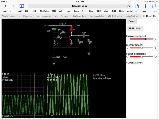

This config. may be suboptimal for output to meet your requirements of linearity and 2Vpp 27MHz into 50 ohms. It uses an emitter choke to raise the Q and source impedance into the "pi" filter feedback but may be somewhat spurious with reactive loads.
I changed it to a common emitter with R's added to linearize the base impedance and regulate the gain with R ratios to get a somewhat balanced sinusoidal output for the load and V+ used.
Here is my interactive simulation. It is a bit power hungry, as this class is low efficiency and indicated by colour mapping in red.
The AC coupled collector load must always be slightly larger than the Rc value to V+ in order to keep collector current from being starved.
C1 or C2 can be tuned with a varicap with various configs such as L or T divider is a different topic.
In theory with neglecting Miller capacitance, \$LC=\dfrac{1}{\omega ^2}\$ so 27MHz, 1uH, Ceff=34.7pF and in this simulation 70//72pF=35.5pF shows good agreement.

    Note that asymmetry is present which can be computed directly from my scope peak outputs; max + min (/ mean*100%) for ac coupled 50 ohm output or 1.17Vmax, -1.10Vmin or +-3% distortion. – Tony Stewart EE75 Aug 22 '17 at 20:44
  • Thanks, this really helps. So as far as I understand the emitter choke prevented the signal from basically going into ground in the original design. What serves the same function (if it is even necessary) in your design? – Anthropomorphous Dodecahedron Aug 22 '17 at 21:28
  • Colpitts comes in all 3 common pins; CB base, CC collector and CE emitter. Output impedances for CC with output at emitter are lower and tend to reduce Q. Mine is CE with current source out. So L is necessary to raise source Z(f) in emitter but not for CE. Did you try my sim? – Tony Stewart EE75 Aug 22 '17 at 22:07
  • Don't know where "Colpitts" ends and "Pierce" begins (I think it hinges on where you apply ground). Seems a good arrangement to drive a low-impedance load. It still requires a good local bypass capacitor from DC supply to ground. Upping the power like this may make the design somewhat squirrely. – glen_geek Aug 22 '17 at 22:11
  • good call @glen_geek it is more a Pierce which has emitter as AC gnd, but works better IMHO. So improved stability can add small Re. but DC current standby must exceed AC current peak in this with C coupled load if loop is opened – Tony Stewart EE75 Aug 22 '17 at 22:21
  • I did try the simulation and played around with it a bit. However when I built it it didn't want to start up. I am trying to troubleshoot it now. – Anthropomorphous Dodecahedron Aug 22 '17 at 23:23
  • Interesting, LTSpice also says it doesn't work: http://prntscr.com/gbuvo1 . I am not sure if I am doing something wrong or if falstad simulator is. – Anthropomorphous Dodecahedron Aug 23 '17 at 00:20
  • unfortunately the design was very sensitive to hFE for achieving near unity loop gain and Falstad model is ideal with constant hFE which will change with Vbe , Ic and Vce. So pull the feedback R off and reduce the other R's by 50% or until oscillation is sustained. or back to the dwg board as they say. The design has difficult limitations and one is better off using a ceramic resonator or better care in device selection and adaptive gain control. – Tony Stewart EE75 Aug 23 '17 at 05:13
