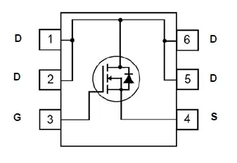

The FDC855N comes in a 6-pin package, 4 of which are connected to the drain, and only 1 to the source. Why this difference? The source sees the same current as the drain, doesn't it?

That's not for the high current, it's for heat management.
The single source pin can handle the current, and so would a single drain pin. Schematically a MOSFET is often drawn symmetrically, because this way it's easier to show the asymmetry in the channel's conductivity.
But discrete MOSFETs aren't constructed that way. More like this:
It will probably be packaged upside down, with the bulk of the drain connected to the lead frame which directly connects to the 4 pins. Gate and source will be bonded to their pins.
The bulk of the MOSFET will dissipate the most heat, and because its direct contact with the pins the heat can be drained through the pins, it's a path with low thermal resistance. The drain may still be wire bonded as well, for proper electrical connection. But the bonding wire will pass much less of the heat.

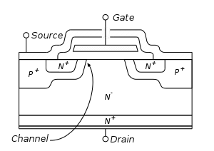

Most power MOSFETs are classified as vertical-diffusion MOS as compared to the planar or lateral MOS used elsewhere. This is largely because to maximise current carrying capability, you need an extremely long but narrow channel, which is hard to do using the textbook symmetrical MOSFET. The exception to this will be power MOSFETs designed for audio amplifiers - these are lateral MOS and you will usually find that they are conventionally heatsunk a a result.
VDMOS structure
