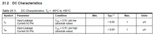

If that MCU pin is configured as an input, then there is almost zero current, for a static input voltage which is within the allowed voltage range for that IC (often, but not always, limited by the supply rails). Check the datasheet for your specific MCU - look for the "input leakage current" parameter, typically a few nA.
From page 161 (in the current version) in the ATtiny85 datasheet, I have edited one table to show only these relevant values:
extract from ATtiny85 datasheet showing input leakage current values
Here you can see that typical input leakage current is < 0.05 uA (< 50 nA) for that device.
