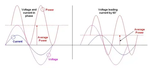

Voltage and current waveforms have an amplitude but they also have a phase relationship: -
The left picture shows voltage and current waveforms in phase i.e. they rise and fall together. The right hand picture illustrates a phase lag on the current.
The red curves for both is power and even though the amplitudes of voltage and current are the same in both pictures, the average power in the right hand picture (what you are billed on) is lower.

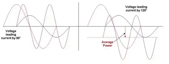

Here are more extreme examples: -
The left picture shows current lagging voltage by 90 degrees and the average power is zero (there are equal amounts of power taken from the supply as given back to the supply). The right picture shows a negative average power because the current's phase angle has moved to a point where it is generally inverted i.e. it's positive peaks are closer to the inverted voltage waveform's negative peaks. This is an example where power is flowing out from a "user" and back into the power grid.
How does the meter differentiate between imported and exported energy?
Imported energy is when the current is flowing into the load as typified by the top two diagrams. Average power is positive. Exported power would be a negative value of average power as typified by the lower right hand diagram.

  • In examples shown, aren't voltage and current out of phase.. ie isnt this reactive power as opposed to exported active power? – dazza Aug 14 '17 at 14:13
  • @dazza when average power is not-zero it is real power (measured in watts) either flowing in or flowing out. This is v x i. Reactive power will be zero when v and i are in phase and will be maximum when v and i are at 90 degreees. See this: http://www.electronics-tutorials.ws/articles/reactive2.gif. Because of the cosine/sine relationship reactive power is maximum when real power is zero. At phase angles other than 0 degrees and 90 degrees or multiples thereof, reactive and real power both exist. – Andy aka Aug 14 '17 at 14:55
  • @Andyaka OK Im struggling. Before you used voltage leading current as an example of exporting. To me that just looks like a lot of reactive power as current and voltage are out of sync. Our generation equipment runs with a PF of 0.99 to 1.0 which I interpret (perhaps incorrectly) to mean we're not creating or consuming a lot of reactive power to/from the grid, ie current and voltage in phase... so again.. with current and voltage in phase how do you know which way power is going? – dazza Aug 15 '17 at 15:37
  • Exporting (as in giving average power back to the incoming supply) is when the current lags voltage between 90 degrees and 270 degrees. This naturally causes average power to be negative. Biggest export is when current is exactly 180 degrees out of phase with voltage. – Andy aka Aug 15 '17 at 16:35
