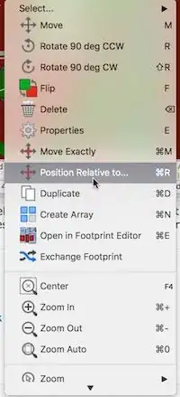

The easiest way is to use the "Position Relative To" command. On a Mac, it is ⌘-R, under Linux, it is Ctrl-R. Or, you can access it using the right-click on a part or group.
Position Relative

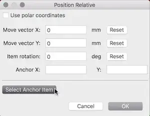

Once you have selected this, you can choose an object for the reference
Position Relative Dialog
You will need to be running version 5 or higher for this function.

  • Is the "position relative" feature only in the nightly release? I'm using 4.0.7 and I don't see that option in the right-click menu. – Cerin Aug 13 '17 at 12:43
    Yes, it's only in the nighties for now (see end of my answer. :). But the nighties are pretty stable and really the way to go, feature-wise for now – Seth Aug 13 '17 at 21:40
    I'm using Version: 5.0.0-rc2-dev-unknown-73b9a5~65~ubuntu14.04.1, release build and this option appears to be broken. I can click "Position Relative To..." in the right-click menu, but nothing happens. No pop-up window like you show here. – Gabriel Staples Jun 25 '18 at 06:13
  • @GabrielStaples Please report this as a bug. It should be working as described although the window will look a bit different than it did back in August. – Seth Jun 25 '18 at 18:27
  • Done! https://bugs.launchpad.net/kicad/+bug/1778624 – Gabriel Staples Jun 26 '18 at 03:30

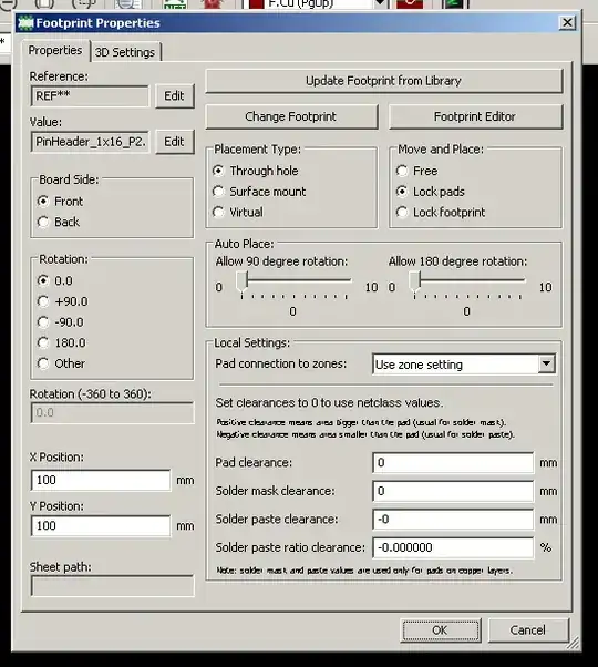

In properties set the x,y of your first pin header, e.g. 100,100.
Do alt-v, s to specify the grid origin, giving the same x,y coordinates.
The pin header footprint now looks like this.

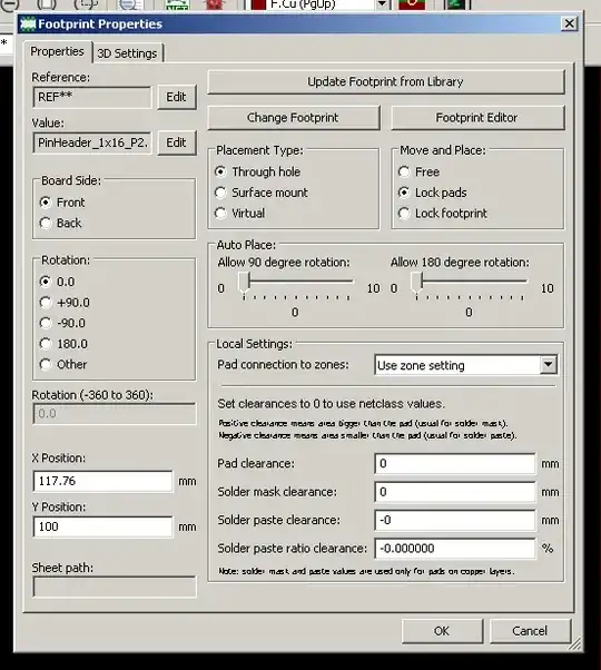

Place the second pin header and enter it's relative x,y coordinates, e.g. 117.76,100, (or ctrl-m on the parts to move exactly, setting the radio button "relative to grid origin").
Ending up with the two headers aligned the correct distance apart.
