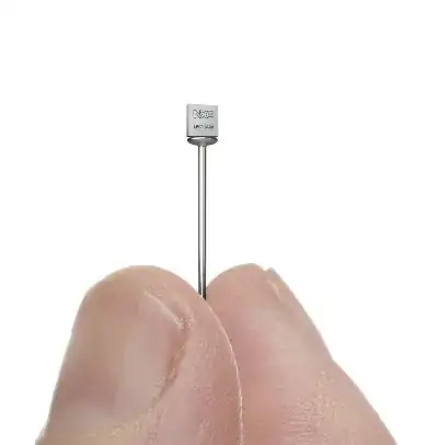

ARMs often require large packages, either to accomodate for a large die with a lot of Flash, or because the different functions require a lot of I/O pins. But this package illustrates the possibilities ARM offers.
This is a 16-pin ARM in a package just 2.17mm x 2.32mm.

  • What's the part number of that ARM CPU ? – Rocketmagnet May 17 '12 at 17:14
  • @Rocketmagnet looks like maybe an NXP LPC1102UK: http://www.nxp.com/products/microcontrollers/cortex_m0/miniature_package/LPC1102UK.html – Craig May 17 '12 at 17:47
