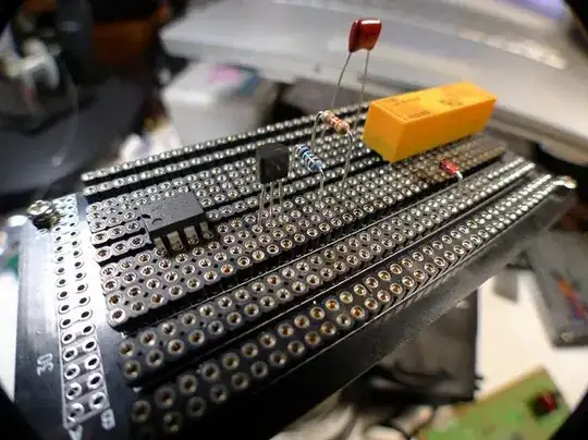

Have a look at this Headerboard design...
It's a good looking alternative to the humble breadboard, it looks like the connections would be nice and firm too.
If the link goes dead, it uses turned-pin socket strips on a perfboard which happens to have the same layout as a conventional breadboard.
