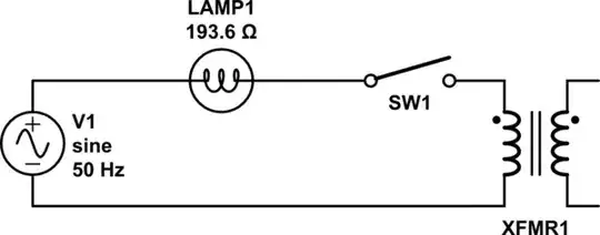

Here, the lamp is limiting the current going into the main winding of the transformer to 250w.

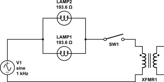

In theory, if I wanted to increase the maximum current going into the transformer, I'd have to modify the circuit to have more light bulbs in parallel like this.
schematic
simulate this circuit
Since the resistance in parallel can be calculated this way:
1 / Rtotal = 1 / R1 + 1 / R2 + ... + 1 / Rn
1 / Rtotal = 1 / 193.6 + 1 / 193.6
1 / Rtotal = 2 / 193.6
1 / Rtotal = 1 / 96.8
Which reduce the resistance to 96.8 ohms and then the maximum current flowing in the transformer should be:
V = IR
220 = I * 96.8
220 / 96.8 = I
2.272727273 = I
I*220 = 500
In theory adding any light bulb with a certain wattage rating in parallel to other light bulbs but in series with the transformer should increase the maximum current flowing to the transformer.
