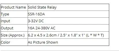

This is the specification of the relay

The purpose of adding a reverse biased diode to a mechanical relay is to prevent a reverse voltage potential appearing at the driver circuit when the magnetic field around the coil collapses, which happens when the relay coil is suddenly disconnected.
A solid state relay does not use magnetic fields. Instead it uses light:
So there is no collapsing magnetic field to generate a reverse voltage potential. It follows no reverse biased diode (or flyback diode) is necessary.

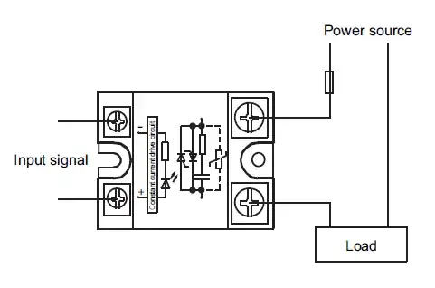

The difference between a solid state and mechanical relay is the inductive coil. For a DC mechanical relay:
how can we decide the diode to connect in this case. I mean any specific values?
The diode D1 must have a reverse voltage rating greater than the power supply V1. Example: if V1 is +15V than I would choose a diode with a reverse voltage rating of 30V or so.
The other thing to keep in mind (but is usually not a problem) is the power dissipation of the diode. When the SW1 goes from closed to open the current through the coil of RLY will continue to flow as the magnetic field collapses (this is what will generate large voltage transients.) D1 provides a path for the current to "flyback" which clamps the voltage transient. The power dissipated in the diode is the forward voltage drop*coil current, but for an extremely short period of time. Because it is such a short period of time it is not something that is typically a problem. I mention it because it is possible to pick a diode which is so small it can't handle the current, or if you have a high switching rate the diode should be pick a bit more carefully.
Also does the diode to connect to the positive terminal of the coil in series with the out from Arduino? Or is it parallel?
The diode connects directly across the relay coil as shown.
Note: If you are trying to control a mechanical relay directly from an Arduino you will have some trouble. Arduino's do not have the required power output for most mechanical relays. You won't find a 25A relay with a 5V/20mA coil. I would use an external bjt and power supply to switch the coil.
