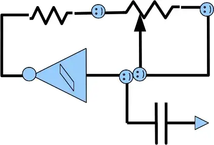

(You can also make a crude ADC with the PIC, but it needs 2 pins which you can use as outputs, and since we already have two outputs and one I/O of the 10F200 is only input, you'll have to give up that buzzer output. Edit. On second thought, you can do it with one I/O, but you'll need two resistors an a capacitor instead of one resistor and a capacitor.)

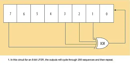

The software will be very much the same as for the PIC: program an LFSR (Linear Feedback Shift Register):
An 8-bit LFSR can cycle through up to 255 combinations before it repeats, a 16-bit LFSR through 65535. Use the potentiometer reading to define the clipping values for the timer.
