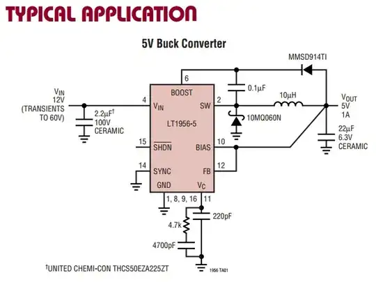

I'm running this regulator off of a ~12V car battery. I've set it up almost identically to the 'typical application' schematic and layout that the datasheet suggests to generate a 5 V output, except that I'm using a 22 μH inductor.

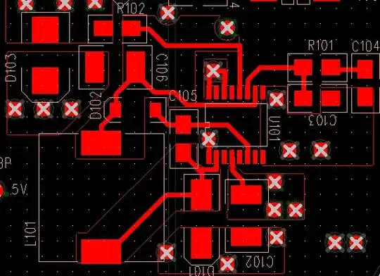

For reference, this is my layout, (C102 is the input cap, D101 is the catch diode, C106 L101 are the output filter network, R102 is a jumper to the 5V plane). The important loop (catch diode/input cap) is at the bottom.

  • What is your CAD program and what are those gray crosses with red pads behind them? – abdullah kahraman May 15 '12 at 16:51
  • I'm using PADS Layout from Mentor Graphics. Those are vias to interior planes (4-layer board) – wjin May 15 '12 at 22:02

Another problem might also be because the regulator is running in discontinuous mode most of the time.
DCM is a good choice of operating mode for this topology, since there's only a type-2 compensation network on the voltage feedback. If the converter transitions to CCM, the added phase boost that a type-3 compensator gives is often necessary to ensure stability.
