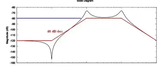

Pictorial analysis of the bode plot: -
I've drawn the red lines on to show what I consider to be flow of the frequency response should the peaks and nulls be subdued. This allows me to say that the resonant peak at 10 rad/s is about 12 dB and ditto at 100 rad/s.
Knowing that for a fairly undamped filter, Q (quality factor) is the peaking value as per this graph on this answer: -
You could use the more precise formula detailed lower down in that picture but I suspect assuming the peaking amplitude = Q is good enough.
So, we can say that Q is approximately 12 dB converted to a real number i.e. about 4. Because Q = 1/2\$\zeta\$, \$\zeta\$ = ~0.125.
We can also fairly well say that with the three resonances at factors of ten difference there is little interaction to muddy the waters too much.

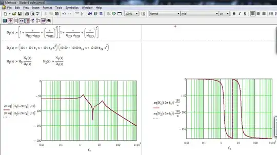

Then plot the polynomial forms and the raw-expression:
As expected, the dc gain is wrong, the notch is misplaced but the poles seem to be ok (the \$x\$-axis in in Hz and not in rad/s). So it seems, at first look, that the problem lies in the numerator while the denominator looks ok. Considering the missing 60-dB attenuation (a ratio of 1000), I have updated the dc gain to \$H_0=\frac{1.001}{101\times10100}=9.8\times10^{-7}\$ which is -120 dB. I can now divide all terms in the numerator by 1001 and plot the newly-resulting Bode plot:
The horizontal scale is now in rad/s and the final result does not look bad : )

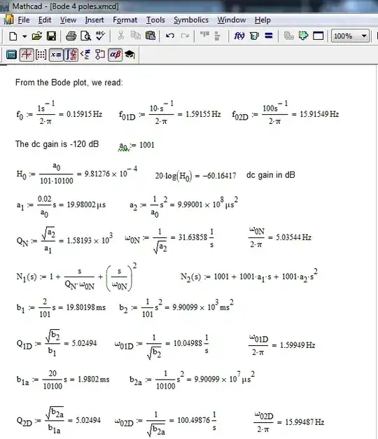

So the correct high-entropy expression is given below, please note the correct dimensions of the various coefficients to keep a unitless transfer function:
You have the values of the various \$Q\$s and resonant frequencies in the Mathcad shots. The damping ratio \$\zeta\$ and \$Q\$ are linked by \$\zeta=\frac{1}{2Q}\$. You will learn more about low-entropy expressions and Fast Analytical Circuits Techniques (FACTs) here.
