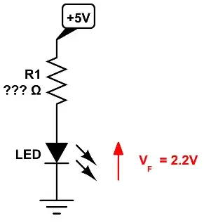

Let's take an example of just a simple LED and a resistor. We know that in a series circuit the current flowing through all components is the same but the voltage drop across each component can be different.
If we want to supply an LED with 3.5mA then that must mean that the resistor also has 3.5mA flowing through it. By simply doing \$R = V_{supply}/I\$ you aren't taking any of the component voltage drops into account.
If we take this example circuit, we can see that the voltage drop across the LED is 2.2V, this is known as the 'forward voltage' which can be found in the datasheet of any LED (this is the same as your 'sustaining voltage' for your nixie tubes).
We have our supply voltage of 5V and the voltage drop across the LED as 2.2V, therefore the voltage drop across the resistor must be 2.8V (\$V_{R1} = V_{supply} - V_{F}\$)
Going back to the earlier point that the current flowing through all components is the same we can now calculate the current flowing through the resistor at a given resistance now that we know the voltage drop across it by using Ohms law.
We said at the start that we want to supply the LED with 3.5mA so our resistance needs to be \$800\Omega\$ (\$R_{1} = V_{R1} / I\$ or \$R_{1} = 2.8 / 0.0035\$)
If we had simply used \$R = V_{supply}/I\$ we would have gotten a resistance of \$1428\Omega\$. Now, if we had used this resistor value, then the actual current flowing in the circuit would have only been \$1.9mA\$ (\$I = V_{R1} / R\$) as the voltage drop across our resistor would have still been 2.8V.
As a final note to remember, you can only use \$R = V_{supply}/I\$ accurately in a purely resistive circuit
