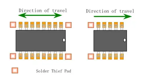

If you design the PCB by yourself you could make a "solder thief pad" also used in wavesoldering. this extrapad will take all the excess tin. enter image description here

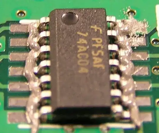

I bought mine from http://kd5ssj.com/solderpaste. The technique.
This line of paste will magically solder all the pins with no solder bridges
A video there showing how it's done, but there are much better videos on YouTube.
