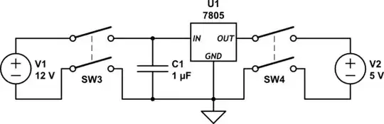

I have a board where I have some electrolytic capacitors on the input side of a voltage regulator. Under normal operation everything is ok. But the board can also during programming of the MCU be fed from the outputside of the regulator. This would leave the cathode (-) of the electrolytes (that might hold charge from previous operation) connected to ground and the anode (+) would be floating.
Please see the following conceptual circuit (not actual circuit!):
schematic
During normal operation V1 is connected and supplying 12V and charging C1. During programming, V1 is disconnected and V2 is connected. The ground level may have shifted and C1 could possibly contain charge.
Do I risk damaging C1 when connecting V2 as the other terminal is floating and one is grounded to a new ground level?
Should I add a diode from OUT to IN to make the positive terminal of C1 not float when the device is being programmed?

    I'd be far more worried about damaging U1 by feeding voltage into its output. C1 will be fine and probably discharged by U1 long before you connect anything else. – Finbarr Jul 18 '17 at 12:37
  • BE breakdown voltage is much higher than V2 so that's not a concern. – Emily L. Jul 18 '17 at 14:05
  • Does C1 count as floating? It is connected to the regulator. – R.Joshi Jul 18 '17 at 14:50

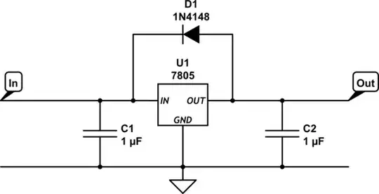

C1 will be fine. Floating is OK, it doesn't count as negative bias for electrolytic capacitors.
U1 might be damaged. Check the datasheet for the specific 7805 from the manufacturer you plan to use for recommendations. You may need to add a diode across it.
You may also want a capacitor on the output to improve stability and reduce noise. Again, check the datasheet for recommendations.

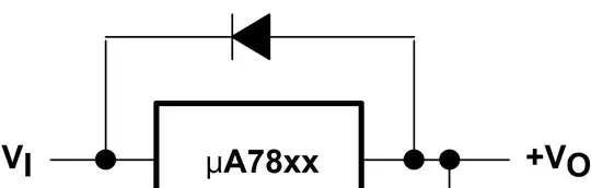

  • As I said it's not the actual circuit and I have the recommended output cap already. The datasheet of my particular IC has no mention of a shunt diode. Likewise datasheets for similar IC from TI says shunt diode is not necessary for 7805 as 5v is less than the 7v be breakdown voltage of the series pass transistor. – Emily L. Jul 18 '17 at 14:10

  • Like I said it's not the actual circuit. Also that's the output side that is 5v. The input is 12v as in the circuit. The data sheet for my part has no mention of a shunt diode and similar parts say that as long as output voltage is never more than 7v above the input then the shunt diode isn't needed. As it's a 5v part, it should be OK as per the manufacturer. I'm more concerned about the cap. I had one board die on me when I powered from the output and I suspect the cap because I removed the IC and it was OK. – Emily L. Jul 18 '17 at 14:12

  • According to your data sheet, there is no description about shunt diode but no details about supplying reverse voltage via output pin too. – CNA Jul 18 '17 at 16:13
  • https://www.google.se/url?sa=t&source=web&rct=j&url=http://www.ti.com/lit/ds/symlink/ua78.pdf&ved=0ahUKEwjlhbDSrJPVAhUiYZoKHbakC0EQFggqMAE&usg=AFQjCNFIGcoW44CRsDj4041QEk3CbnZyZw page 12. Different part though. Can't find anything more detailed on the Fairchild one. – Emily L. Jul 18 '17 at 17:27
  • Yeah. That is the case I have told above. – CNA Jul 19 '17 at 03:21
