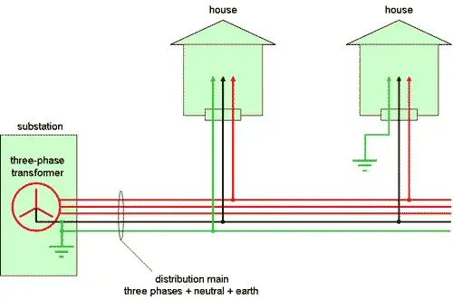

Typical distribution system can be illustrated as:
Here are my premises (and assumptions):
1-) Chassis in a house must be connected to the earth, not to the neutral.
2-) The earth and the neutral are connected together at the substation.
Imagine one lives in a house and there is no earth in the outlet. I have seen such apartments and never understood how they are allowed to wire houses like that.

By the way, the wiring you show for House#1 is not legal in these parts. A separate ground is required at the residence, usually clamped onto the incoming water line if it is a metal pipe, or to a long ground spike. Neutral may or may not be tied to this ground at the fuse box. This provides better local protection as opposed to relying on the electric company and the integrity of the service which may get disrupted (torn down) during a storm.

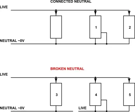

Further there is the broken neutral line scenario which can also be quite lethal. Consider the drawing below.
schematic
Lets assume appliance 4 used the neutral to ground the chassis. Since neutral does not actually go anywhere the chassis is really floating.
However, what happens when you turn on appliance 5. The neutral line coming out of appliance 5 is then pulled up to the live rail. Appliance 4s chassis will also become live. Appliance 5 could be in another room on the other side of the house...

  • If line and neutral are reversed at the outlet and neutral was chassis grounded, in that case circuit breaker will trip. Please see the answer of the user Transistor and see my last two comments under that answer, you will see what Im asking for. Broken neutral is no more superior argument than broken ground. Thats the point I dont get. – floppy380 Jul 13 '17 at 18:55
  • @doncarlos no I meant with no ground. That's why you can't use neutral as a virtual chassis ground. You can't rely on it actually being neutral. – Trevor_G Jul 13 '17 at 18:59
  • yes I got it by saying neutral was chassis grounded I meant neutral was wired to the chassis no earth ground. – floppy380 Jul 13 '17 at 19:00
    @doncarlos if the chassis is earth grounded, you need two (or three) faults to occur for the chassis to be live. 1. earth wire broken, 2 Live wire shorted to chassis. Or 1. earth wire broken, 2. Neutral shorted to chassis, and 3 Plug reversed. – Trevor_G Jul 13 '17 at 19:01
  • @doncarlos if you have no earth line, you need to rely on double insulation instead..... and cross your fingers. – Trevor_G Jul 13 '17 at 19:03
  • Woow I got it now. The probability gets less if we use earth since we need more events occur at the same time. – floppy380 Jul 13 '17 at 19:03
  • @doncarlos exactly :) – Trevor_G Jul 13 '17 at 19:04
  • I will accept your answer since that was what I coundt figure out – floppy380 Jul 13 '17 at 19:04
    @doncarlos thanks. I expanded it a bit to explain the two fault protection idea a bit more clearly too. – Trevor_G Jul 13 '17 at 19:10
  • Your illegal house#1 wiring is actually de rigueur these days in the UK. We earth to the armour on the incomer. – Paul Uszak Jul 13 '17 at 20:33
  • @PaulUszak ya that's probably fine in the UK where most services are underground. Over here a lot of it is still arial. – Trevor_G Jul 13 '17 at 20:35

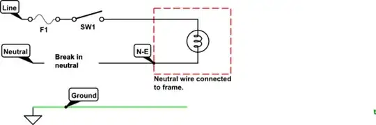

I wrote the linked answer. Here's a variation of the illustrations in that answer.
schematic
Figure 1. Device has had neutral wire connected to chassis.
I have added a fault to the wiring. The neutral cable is broken.
Now consider what happens when someone switches the light on. The top of the bulb goes live as does the bottom and the chassis. This is an electrocution risk.
Even when the neutral is OK there is still a problem. With normal currents flowing there will be a voltage drop along the neutral cable meaning that the chassis will be several volts above ground. Touching the chassis and a properly earthed device or steel sink / plumbing will cause a current to flow through the body. Again, this is potentially fatal.

But now do the same thing with the usual case i.e. with the chassis properly connected to the earth. Now in proper case imagine the live touches to the chassis; and imagine also now the earth wire is broken. Now we have the same situation in your first example. What's the difference?
  • Two faults are required to create the danger. In my Figure 1 a dangerous situation could occur with a single fault.
Neutral wire broken we have problem. Earth wire broken we have problem. Why to prefer still earth to neutral?
  1. Because of the voltage drop across the neutral return wire. This is a serious enough concern on its own. The problems caused by this would vary from not noticeable through ticklish to fatal.
  2. We wish to maintain the chassis at earth potential so we use a dedicated wire which does not carry any current except in the case of a fault.
  3. Your RCD/GFCI would not be able to detect a fault in your scenario. These devices offer additional protection in these cases.
  4. Separation of power and protection circuits.
