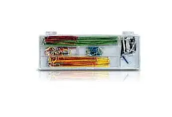

RadioShack sells a jumper wire kit for use with their solderless breadboard. I'm not recommending that to you, since you are outside of the U.S., but using that as an example -- the wires are 22-gauge.
tcrosley
  • 48,066
  • 98
  • 162
    It looks like they also bent the wire at a right angle at the end of the insulation like in the Jameco kit. That is useful for the short lengths where you are directly jumpering 1, 2, or 3 holes, but it is annoying for the longer length. You don't use them that way. It looks like somebody's idea of how you use breadboard wires, not from someone that's actually used them. – Olin Lathrop May 11 '12 at 14:50
    Yes, they do bend the ends like you described. Actually that doesn't bother me, as I tend to lay the wires down flat on a breadboard. I mentioned the RadioShack kit for those in the U.S. since you can get it locally without having to deal with mail order. Some people may find the pre-cut wires more convenient (at a cost). – tcrosley May 11 '12 at 14:55
