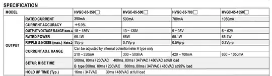

I wish to get 12VDC @ 4 amps from Sager HVGC 65 Watt power supply. Datasheet: https://www.sager.com/_resources/pdfs/product/HVGC-65.pdf
I have attached a picture of the datasheet. I would like to use the HVGC-65-1050. I am confused because it says current adjustment is only from 650 - 1050 mA. But at 12 VDC I should be able to pull atleast 5 Amps right?
It doesn't look like it works as you suppose.
  • At max voltage we get \$ P = VI = 62 \times 1050m = 65\; W \$ as specified.
  • It appears that the output is rated at 1050 mA maximum so the highest power you can get at 12 V is \$ P = VI = 12 \times 1050m = 12.6 \; W \$. (1/5 of the power at 1/5 of the output voltage.

Notice that the area in the green rectangle has to be designed to carry a certain current. In this case it is designed to carry a little over 1 A max on the low-voltage side. For it to work the way you expected it would have to carry 5 A in the transformer secondary, the diodes, etc.
The supply is rated as a constant current design and it's main market will be LEDs - with the possibility of dimming by adjusting the control input. Note that the voltage is not adjustable - only the current. The voltage will rise and fall as required to maintain the set current.
