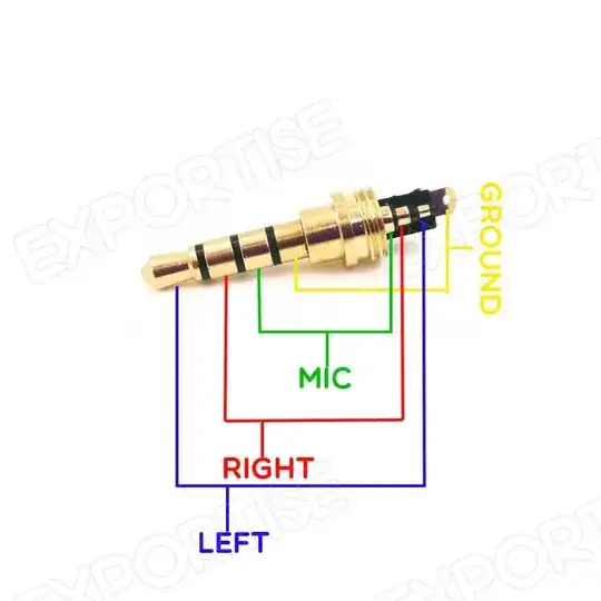

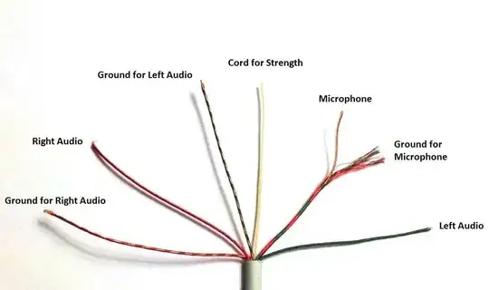

There are 6 wires in total, 3 grounds and 1 for right sound, 1 for left and 1 for mic, something like this:
4 pole headphones wires
Then what I soldered the mic, right, left wires to the their corresponding positions, and then I soldered all 3 ground wires to the ground position (not sure if the grounding of all 3 ground wires together is correct), the positions look like this:

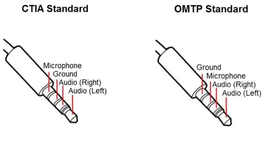

As Chris pointed in one of the anwers, the reason why the buttons were not working was because android uses CTIA specification and I wired things based on OMTP - a comparison is shown below.
CTIA vs OMTP

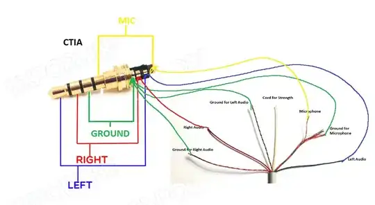

After a rewired things based on CTIA as below, everything worked as expected.
connections

You have wired your connector according to the OMTP standard, with microphone on the second ring and ground on the final sleeve.
However, according to the general Android microphone specification Android normally expects CTIA wiring "Except in regions with legal requirements for OMTP pinout".
CTIA wiring places the common ground on the 2nd ring, and the microphone on the final sleeve.
Most likely, if this is your wiring problem, you would find that you don't have any microphone input (or you get by odd means), and that you have no stereo separation, since your speaker drivers may be effectively in series with one another and without any actual ground.
Of note, the Android document linked above also includes the expected wiring of headset function buttons to ground through resistors of specified value.
