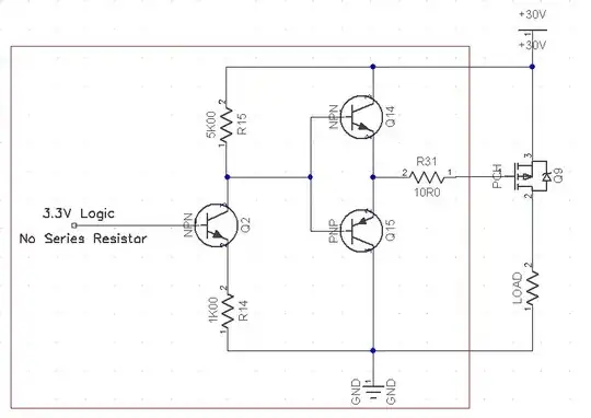

Source of this circuit not certain - via PICList member I think. Can check if anyone cares. Note hat this circuit is considerably more "clever" than may be apparent. (Olin is fond of the input arrangement used here). The ~= 3V swing across R14 causes an about 15V swing about R15 so Q14/Q15 bases swing from +30V to about +15V, providing ~ 15V if high side gate drove to the P Channel MOSFET.

  • So when there is 3.3 V at the base of Q2 its emitter voltage is about 3.3 - Ube = 3.3 - 0.7 = 2.6 V and Ic = Ie = 2.6/1k and the voltage accross R15 is Ic*5000 = 13 V and the voltage at the bases of Q14 and Q15 is 30 - 13 = 18 V meaning Q2's Uce = 14.4 V? And then the voltage at Q14's emitter is 18 - Ube = 17.3 V? Is there a similar schematics for driving the low side N-channel MOSFET? – Chupo_cro Jul 27 '23 at 21:58
    @Chupo_croLow side can usually be driven with just Q14 and Q15 driven by low current drive input. Or as shown but with R14 removed, a Q2 base resistor dded and Q14 driven from a suitable supply voltage - possibly a dropper resistor from +30 and a zener and large enough filter capacitor. || Or you could use this circuit but provide R15b in Q2 collexctor so that Q14 base swings high only to an allowd voltage. || OR ... . – Russell McMahon Jul 29 '23 at 10:40
  • Author of this project linked to your schematics as a start point for his version of low-side 32kHz PWM 5V driver for IRFZ44N at 24V which is not good because max Vgs is only about 4.3V and Zener diode does nothing. I tried to modify your shematics, do you think this would be reasonable? Seems as it could work, Vgs is over 10V but the base current of the PNP transistor (the 2nd from the left) is almost zero. In this project he used your schematics but added a Zener diode which I think is not needed. – Chupo_cro Jul 30 '23 at 19:56
    @Chupo_cro Ask again in 3 days time. Criticalproject happening. I think yours may be better doing inversion (if neded) at imput so high voltage switching concentrates on driver task only. ie move your Q2 (2 from left) to left side to invert. || Where are his links to my diagraam - I cant see them. || His IRFz44N has Vgsth of 2-4 V so MAY work OK in some cases. He also needs a front end level increaser (one more transistor). | A pulled high diode or two may be enough. (Very Heath Robinson :-) ). eg R to 30V pulls up diode(s) to Vin with mybe zener clamp. A trnsistor is easier. || Later. – Russell McMahon Jul 31 '23 at 03:02
  • He linked to this topic under The soldering iron heater paragraph in the sentence "This forum thread explains the problem in details." - the word "This" is the link. If you open the link I posted before with Chrome, the paragraph title will be highlighted. He apparently used your schematics but made a mistake when trying to convert it for N-channel low-side MOSFET. Yes, Vgs(th) is max 4 V but Rds(on) is 22 mOhm only when Vgs is above 10 V (and under 20 V). In my schematics there should be 14 V swing at the gate. You can flip the switch and check the voltages with the mouse cursor. – Chupo_cro Jul 31 '23 at 03:25
    @Chupo_cro Yes. " ... MAY ..." :-) :-(. || Something to try for now. Input transistor with base via R to say 3V3. Drive emitter with Vin. Collector to some Vhigh. This gives a non inverting high swing drive at collector. Cn be zener clamped if desired or whatever else suits. || Later ... – Russell McMahon Jul 31 '23 at 03:32
  • I'll try to find some solutions in the next few days. The final solution should work with 5 V signal and 24 V supply for the heater. In his next project for the very same soldering iron he used the exact your schematics without changing the resistor values (this time he used P-channel high-side MOSFET) but then the voltage swing at gate was to high and he used a Zener diode. But I think it is enough to only replace the 5k resistor with 2k7 like this. – Chupo_cro Jul 31 '23 at 03:40

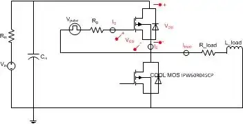

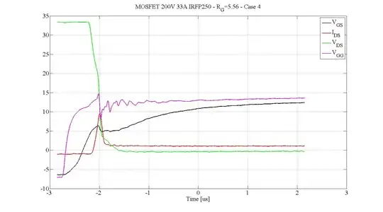

Here are some waveforms that indicate some of the transient natures of a large MOSFET. The gate current gets high during switching and may have caused a dip in the gate drive voltage here. (black line) timing test schema.
