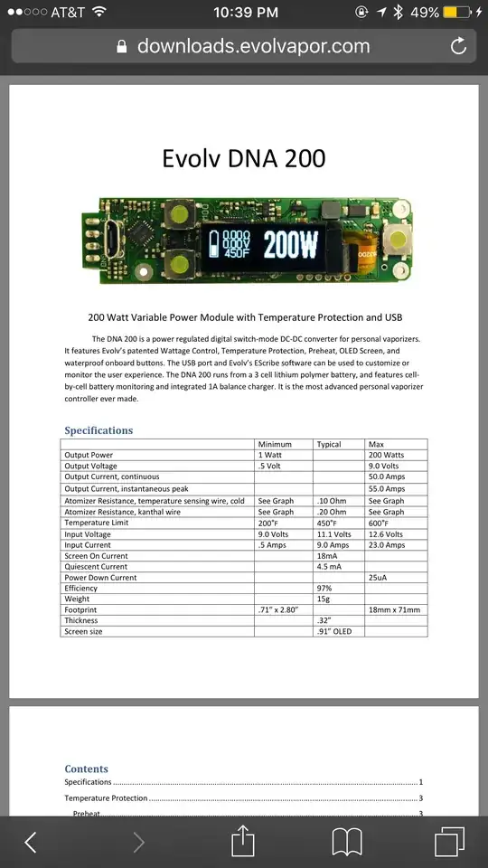

Hello, I'm trying to adapt a vape mod so I can plug it in directly to my car cigarette lighter instead of using batteries. The device I'm using has a DNA 200 chip in it and according to the datasheet max input voltage is 12V and max amps is 23. According to a google search a car batter puts out around 48 amps. From my understanding the device will only draw as many amps as it needs or am I wrong? Could I connect the leads of my cigarette lighter adapter straight to the board or is there anything special I should do? Here is the full data sheet for reference.
Also I know it has a charge port on it. Problem is it charges to slow and I'm tired of messing around with batteries on long road trips.
You are right that it will only draw as much current as it needs.
However, the cigarette lighter plug has a 10A fuse on every car I've been in so you won't be able to draw 23A from it without it blowing.
Also keep in mind that the 12V from a running car is not regulated and can be anywhere between 11-14V (even dipping down to 8V when cranking) with possible nasty spikes from the alternator. If you plug it in directly, you may damage the onboard electronics.

  • Wow I didn't think of the 10amp fuse. But lets just say I ran new outlet in the vehicle with the proper size wire and bigger fuse. Would installing a capacitor help keep the voltage steady? – Kuhlman Gabriel Jul 07 '17 at 04:08
  • The automotive electrics are pretty horrible to deal with. You'll need to read more into getting clean input power but you're also dealing with quite a significant amount of power (~275W) so I'd say to just forget it. – tangrs Jul 07 '17 at 06:46
