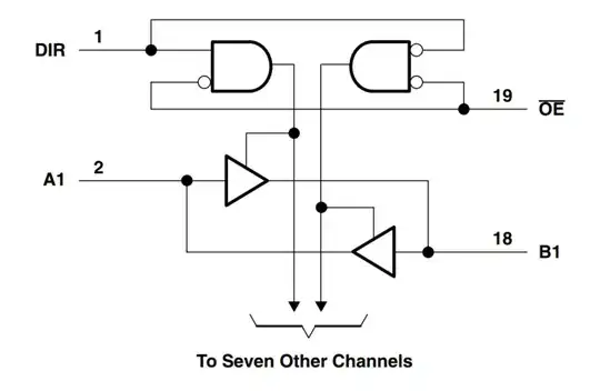

SN74ABT245 has the right topology and function, but it has way too many pins because its an 8-channel device, and it's also TTL and thus has low output impedance (only guarantees 3V output with 5V VCC.)

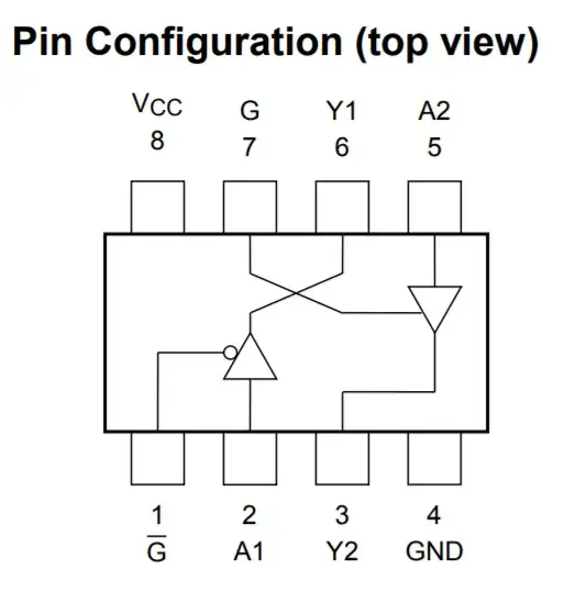

I finally found a part that works!
TC7WT241FU
It's the TC7WT241FU. It has very tolerant Vinhi of 2V even with 5V Vcc. It has two enables, one of which is the inverse of the other. It outputs at least 4.18V (typical 4.5V) for high, at 4.5V Vcc. It switches in less than 40 ns, which is a bonus.
