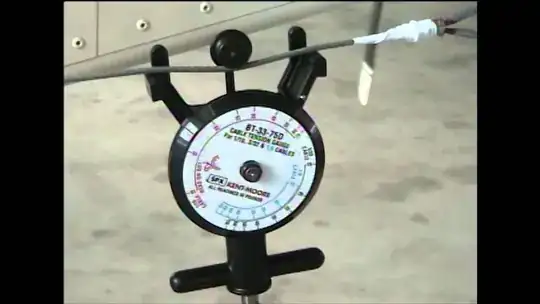

You don't need something that goes in series with your rope. Google "cable tension meter" and you will see a lot of configurations that work on the same principle as this https://www.youtube.com/watch?v=aDb0SnNdSh8
tension meter
I don't see any great difficulty in home brewing this kind of tension meter. A spring loaded plunger and a way to measure how far the plunger moves. Calibrate it with weights on the rope hanging vertically, and a look-up table in an Arduino Nano or similar simple micro.

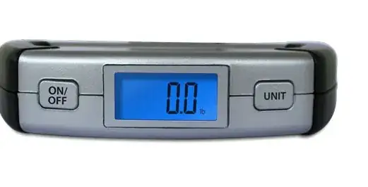

There are also (probably less convenient) sensors in digital luggage scales that are even cheaper, even if you buy one and throw away the electronics.

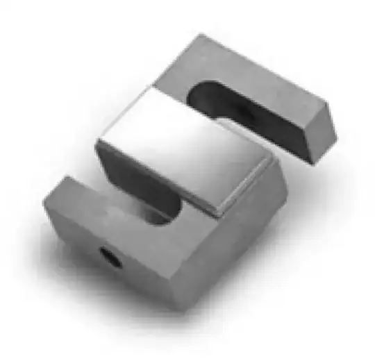

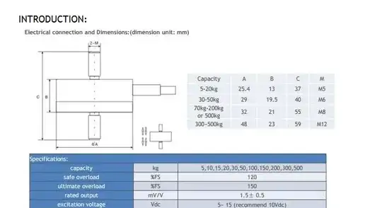

If you don't wish to homebrew your own transducer, look into "strain type load cells". These are typically found in S and Z type configurations. An example of an S type cell that is available for $130 USD can be found here.
You will have to add your own means of mechanically fastening the rope ends to the cell but most come with tapped holes for easy attachment of eye bolts or similar.

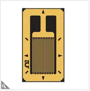

Get a few of these from eBay, £50 for 10:-
gauge
Glue it on with some epoxy and solder a couple of wires on. This is the standard technique for ad-hoc force measurements. Wheatsone bridge + opamp /instrumentation amp and you should be there. There's a good guide here as to gluing them on.
Glue them onto anything metal that's rectilinear. I mean it's long and thin so that you get even strain across the cross section:-
rod
You could even bend a steel strip say 500mm long to form hooks either end. Stick a gauge each side of the strip. Some simple formulae will allow you to determine the overall strain and allow for any bending moment. The type of metal doesn't matter as long as you know what it is to get the Young's modulus. Just don't make it too thin as to neck it at the gauge location when you pull. 1000N is nothing. Get a 10 x 2mm strip from somewhere that'll allow you to identify the metal.
