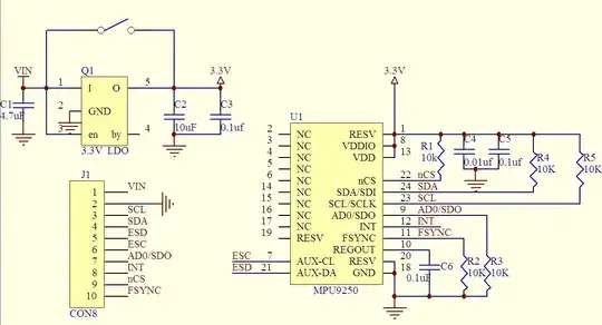

There's no information about what value pull up resistors to use. Doing a quick search on google for mpu9250 schematics I see this schematic enter image description here
It uses 10k resistors as pull ups. My question is whether this is accurate, and more importantly can I settle for 4.7k resistors since those are what I have lying around?
    It's not the MPU9250 which determines this, but I2C in general. 10K may work, but sounds a bit high. Something in the range of 2.2K - 4.7K is typical, so you could use one 4.7K resistor per line, or even put a parallel pair on each. – Chris Stratton Jun 21 '17 at 06:22
  • @Stratton thank you this answers my question. If 10k is too high, why does every schematic I've seen so far use it? –  Jun 21 '17 at 07:00
  • Laziness. At least it's not using the internal pull-ups of an Arduino, which are typically 3-5x bigger... – Majenko Jun 21 '17 at 08:29
  • 10K is not always too weak. It depends on the circuit loads and the needs - see the link. – Chris Stratton Jun 21 '17 at 14:45
