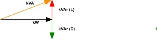

schematic
Figure 1. An inductive load (L) without capacitive correction would end up with a kVA magnitude greater than the kW magnitude. Adding the equivalent capacitance will cancel it out.
In effect we set up a tuned circuit between the L and C so that the reactive current component sloshes around between them without drawing additional current from the supply. Without them the out-of-phase current causes a higher current to be drawn from the grid than that which is required. This causes increased voltage drop along the supply lines and this is where the majority of power loss occurs.
