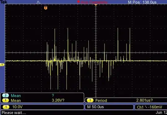

Update: Problem found. See photos of PSU voltage wild excursions when turning off:
scope image of power-off
and turning on:
scope image of power-on

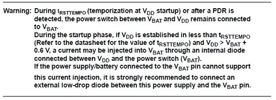

  • In the current version of ST Reference Manual
    RM0091: STM32F0x1/STM32F0x2/STM32F0x8 advanced ARM®-based 32-bit MCUs it says in section 5.1.3 (Battery backup domain) on pages 80 / 81:
    Excerpt from ST Reference Manual RM0091 - VBAT supply during power-on
    tRSTTEMPO is shown in the STM32F091 Datasheet section 6.3.3 (Embedded reset and power control block characteristics) on page 55, as being between 1.5ms to 4.5ms, with a typical value of 2.5ms.
    Therefore as I understand the above warning, if VDD rises within that time and VDD > VBAT + 0.6V then current injection to VBAT can occur.
    I haven't see the VDD voltage mentioned in this topic yet, to know the result of the above formula. However adding the "low-drop" (e.g. Schottky) diode recommended by ST, seems like sensible mitigation to avoid potential problems caused by this behaviour inside the MCU.

  • Sscreenshots of my PSU when switching off(https://i.imgur.com/ocEkqxA.png) and on(https://i.imgur.com/wL9y1RR.png) across a 100k resistor. I suppose those high voltage peaks are a strong candidate for villains, right? – MarcelNubi Jun 12 '17 at 17:00
    It turns out my PSU was busting the VBat pin. When powered from a cleaner source, the problem was gone. Thanks. – MarcelNubi Jun 12 '17 at 20:28
  • @MarcelNubi - I just started to look at those scope images, when I saw your next message that you've found the problem (good!) :-) So just to be clear: (a) You said it was the PSU that was damaging the VBat pin. Do you mean it was the USB PSU which you mentioned was powering your VDD (via USB Vbus), or was it the bench PSU which was powering VBat? (b) Those scope images don't seem to show a DC change between start & end, as we would expect for power-on or power-off, so I'm confused. Was the scope set to AC input coupling? (c) Related to (a) - were those scope images of Vbat or VDD? Thanks. – SamGibson Jun 12 '17 at 20:40
  • I guess that the answers are (a) it's the PSU for Vbat; (b) scope was set to DC, but these spikes occurred when the PSU output voltage was already in steady state i.e. not while the voltage was actually changing as expected, during the power-on/off; (c) the images were VBat. If I interpret the images correctly, there is a -6V spike (1.1 divisions @ 5V/div) during power-on and spikes of over +/- 20V (over +/- 2 divisions @ 10V/div) during power-off. Very scary! I'm glad my suggestion to check VBat was helpful. Good luck! – SamGibson Jun 12 '17 at 21:09
  • a) Yes, PSU for VBat. When powered from a clean source, those spikes were gone. b) It was set for DC but the time window was really short(50us). Those spikes happened before the power went up to 3V or down to 0V. Scary indeed.. time to purchase a better PSU, right? – MarcelNubi Jun 12 '17 at 21:40
    @MarcelNubi - I did some tests with a bench PSU at work, and (as expected) couldn't reproduce similar spikes. The magnitude of the spikes in those scope images might be inaccurate, due to the possible effects of long scope ground leads etc., but even if the spikes were half as big, they would still be a problem. "time to purchase a better PSU" Or find/repair the fault in the existing one; or leave the PSU switched-on (assuming it doesn't produce the spikes while on) and add something like this on the output, to perform switching without spikes. Good luck! – SamGibson Jun 13 '17 at 17:02
