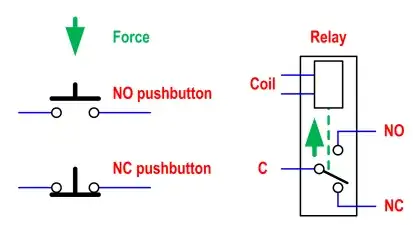

Schematic
(The drawings show the state in the absence of force.)
When you press a normally-open pushbutton, you provide a path for the current.
When you press a normally-closed pushbutton, you impede the current from flowing.
In a relay, when the coil is not energized, C and NC are connected. When the coil is energized, the magnetic field attracts the movable metal, and C and NO are connected instead.
