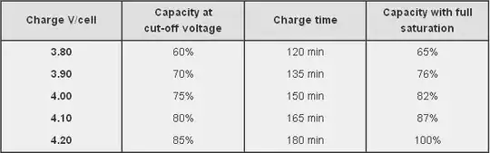

Here is an immensely informative chart, care of Battery University, that tabulates the effect on capacity of various endpoint voltages and charging cutoff point. eg the traditional maximum charge voltage is 4.2V. When this cell voltage is reached the cell has 85% or maximum capacity. If charging is at 1C then this occurs in about 85% x 1 hour =~ 50 minutes. If charging is allowed to continue for another 180-50 = 230 minutes the capacity will be 100% and charge current will be close to zero - say maybe 1% of max. Leaving the charger connected will have minimal additional charging effect BUT may destroy the battery. Disconnecting the charger when 4.2V is first reached will reduce available capacity by 15% BUT will increase cell lifetime by much more than 15%.

Best cycle life at a given end-point voltage is achieved by stopping charging when the voltage "pedestal" is reached. As per the above table this gives 85% capacity at Vpedestal = 4.2V, and 75% at Vpedestal = 4.0V.
