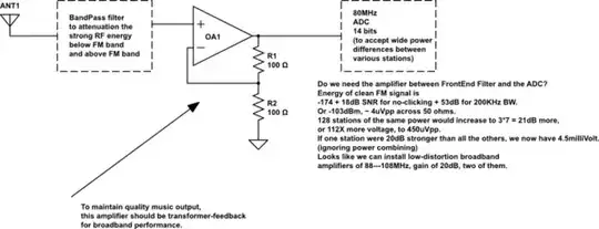

schematic
So you want to SELECT one station in the FM band?
How about digitizing ALL the stations, then use digital filtering. IN that case, Fsample of 80MHz will downconvert the entire FM band of 88-108 to 8MHz --- 28MHz.
If you want just one station, use the NE602 with LO 40MHz higher 128--148MHz, creating low-side IF into some LC filtering and 40MHz (OPamp?) amplification, then down convert again with another NE602 using fixedLO for the 2nd IF to get amplified and digitized by Ardunio [phasenoise aka jitter of Sample clock may set your SNR]
I'm assuming you want a quality musical output. If you just want low-rate data (rate << Ardunio 10KHz), implement a lowIF frontend. That is, for 88MHz data at 2Kbit/second, use 88.005MHz LO to produce 5KHz IF. Do not mix down to DC (that is, do not use Zero-IF because you'll then need I+Q IF strips to preserve the FM data)
