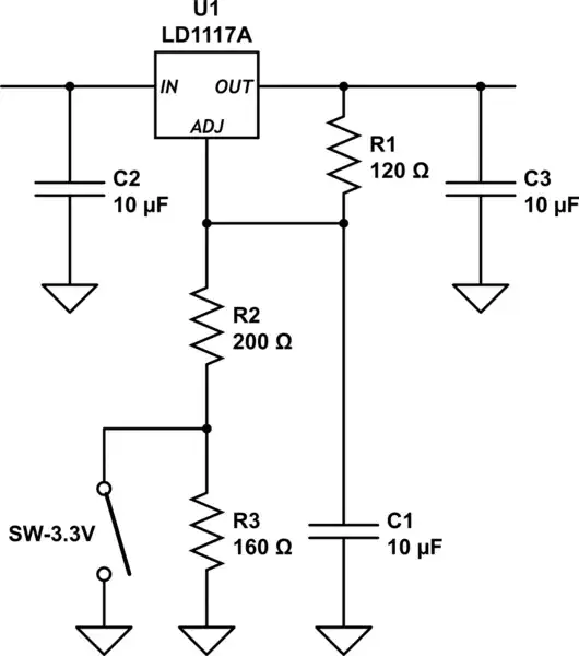

Not a good idea bypassing, it will just sit there and eat power.
Instead, use a single LD1117A in adjustable mode, and switch out the resistor.

  • How much power do you think it will eat? And how does your solution deal with the drop out? – Passerby May 26 '17 at 20:15
  • @Passerby what dropout? OP did not mention drop-out requirements? – Trevor_G May 26 '17 at 20:17
  • OP says short input to output. That means input is likely the 5V, so he is bypassing it completely. The LD has a drop out. So how does your solution deal with that. And more importantly, how much power do you think it eats. – Passerby May 26 '17 at 20:19
  • @Passerby I guess you COULD read it that way.. or you could read it he is regulating 5V then stepping it down to 3.3...which is how I read it... But you are right, it he is feeding the circuit from a pre-regulated 5V the above won't help. Re power.. it's only 5mA, but if this is running off a battery it all counts. – Trevor_G May 26 '17 at 20:24
    He's making a programming adapter. So I don't think battery power is a concern here. – Passerby May 26 '17 at 20:28
  • @Passerby u may be right.... – Trevor_G May 26 '17 at 20:33
  • If he's making a programming adapter, then he's almost certainly using USB voltage, meaning this solution definitely isn't workable. – Sneftel May 27 '17 at 07:48
