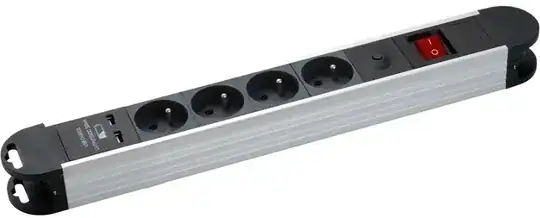

In RL I noticed that power supply cables with possibility to charge one mobile through USB compatible socket actually exist: Ignore sockets, but look at USB ports
I actually started to wonder, whether for purpose of world building such idea could be move much more further. I mean both electronics and LED light has to convert electricity to low voltage DC, so the voltage would be already converted earlier.
OK, so the question is following: Would additional low voltage DC sockets be practical on mass scale for purpose of connecting small electronics and light? (Safety gains? More efficient conversion at socket instead of dozens of tiny converters? Only less cable clutter? Extra: Roughly which voltage would be reasonable?)
