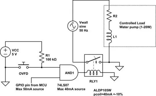

Here is the design that I have come up with:
schematic
I couldn't find a symbol for a terminal so I used the normally open push button (labeled OVFD for OVerFlowDetector) symbol for my overflow detection switch.
It will basically be two electrodes at the bottom of the tray which are normally open and will close when water collects in the tray. I have a weak pull-up to 5V when OVFD is opened.
I then AND this with the control signal from the MCU GPIO pins (5V, 50mA max) and use this to drive the relay which is a SPST (I think?) with Ucoil = 5v and Pcoil=200mW (40mA).
The relay is normally open (pump disconnected) and will connect the pump to the 230VAC 50Hz from the wall socket when closed. Is this the proper way to use a relay? Now when I look at it, it seems odd... Do I need a SPDT relay?
I'm also a bit worried about driving the relay. The relay needs 40mA to switch and according to the datasheets on the 74LS07 it can only source 40mA. Do I need some kind of current amplification or will it work anyway?

    You must not ground any part of the AC section of the circuit, or connect it to the Arduino circuit (other than through the relay, which provides galvanic isolation between the control and switched circuits). – Peter Bennett May 15 '17 at 23:47
  • Of course, I'm just used to putting a ground on every isolated circuit for simulation purposes. The ground wouldn't be shared with the MCU and the HV circuit. – Emily L. May 16 '17 at 00:22

You've made a great attempt, but I'd suggest the following:
  1. You need a diode across the relay to protect from the inductive kickback when turning off the relay damaging any driver.
  2. You get better drive if you connect the relay from +5 to the gate output since it's a saturated transistor.
  3. You just need your water level detector as an input to your MCU, you don't need to gate it with a signal from the MCU through an external gate. You have software to do all the logic.
  4. Driving any relay that has 120-240 V on it is always hazardous, I'd suggest you buy a module rather than build your own circuit.

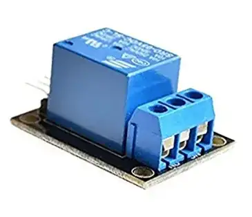

You can buy very cheap Arduino peripherals such as this relay board from various sources such as Amazon or Ebay. They have reasonable output connections for the AC side and you are likely to find it much easier and safer to hook up. enter image description here
This board already has a transistor driver and protection diode built in so all you need is a port signal, 5 V and Ground from your MCU to turn it on an off.

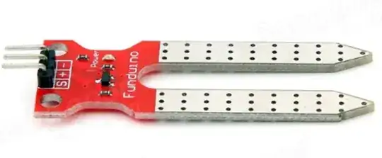

There are also plenty of water level sensors for Arduino such as this moisture sensor ...they almost universally have an on board transistor and hook directly to an MCU port. enter image description here

  • The whole point of the overflow kill is to protect against software errors (bad PID settings causing overshoot or bugs for example). Using software to guard against software issues is a no-go in my book. Yes BOD and WDT can catch some power/sw issues but not all. The hardware AND solution buys me peace of mind. – Emily L. May 16 '17 at 00:20
  • Regarding #4, yes I'm aware of the risks and I am infact using a bought relay module during prototyping. But I want to produce a small, neat PCB with everything integrated for the final thing. And this is also something I want to learn for future projects :) – Emily L. May 16 '17 at 01:30
  • I think your peace of mind should include failure of the relay driving transistor (a short) or failure of the regulator running the MCU. Really this is not even a reasonable attitude, your killswitch gate could fail, or the killswitch sensor fail ....what would you do for that? If you really want peace of mind then double or triple redundancy might help. 3 MCU's running different code in a majority rule for each output should do it. – Jack Creasey May 16 '17 at 02:35
  • Why is removing more (but not all) sources of failure for a miniscule cost compared to a removing less sources of failure, not a reasonable attitude? – Emily L. May 16 '17 at 08:13
  • Purely my opinion, an MCU running a simple bit test logic (no PID or complex interaction) for the overflow tray compared to a standalone Analog test AND an MCU signal ...it seems the MCU would be more reliable. – Jack Creasey May 16 '17 at 15:47
  • The MCU is running a PID and UART command line. It has 64 bit time library (through my implementation of std::chrono::steady_clock using timer 2). It has reliable sleep(duration) which puts the MCU in deep sleep with only timer IRQs running etc. The MCU will also perform other types of control later. It is not a trivial program. – Emily L. May 16 '17 at 17:42
  • I didn't say your program was trivial, I said it was more reliable than external logic IMO. It's purely your decision of course. – Jack Creasey May 16 '17 at 18:08

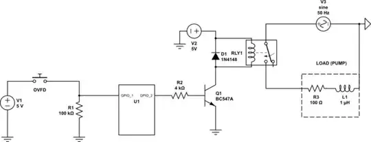

Your problem is quite simple, and you don't need the AND gate, it's more suitable to use your microcontroller to perform the action to stop the pump.
That would be my circuit to do so, sorry for the mess. The GPIO_1 is responsible for the input from the OVFD, this works exactly as a button, when there's water, the electrodes short and the current flows to the resistor (5V), if there's no water, then, there is no current in the resistor (0V); Concerning the relay, the most usual is a SPDT, and to activate it, I recommend a NPN transistor to protect the microcontroller.
I guess that's it, pretty basic, but you will protect your circuit and avoid using another IC.
schematic
EDIT: Changed R2 value according to @Tony Stewart. EE since '75, but, be advised, that this value depends on your components.
  • The problem with this design is that any problem with the MCU will prevent the fail safe from triggering. Why the diode? – Emily L. May 15 '17 at 23:36
  • Oh, you need a fail safe proof kill switch, sorry, didn't notice before. As Jack said: You need a diode across the relay to protect from the inductive kickback when turning off the relay damaging any driver. –  May 15 '17 at 23:43
  • In this case, only add the transistor after the gate and, concerning the current you won't have any problem, since it will drain from the power source, not the IC itself. –  May 15 '17 at 23:52
  • @TBorges R2 must drive 2mA to drive a 125 Ohm 5V relay coil for 40mA with Ic/Ib= 20 . Your 10k only gives 0.43mA base current. pls fix. but I would buy the relay cards with drivers, much easier. – Tony Stewart EE75 May 16 '17 at 00:25
  • Is it beneficial to put a resistor in series with the diode to help dissipate the flyback current? – Emily L. May 16 '17 at 00:26
  • No @EmilyL. the diode conduct current at the same peak level and direction into the coil but decays at ESR/L rate. in fact current does not increase it just commutes from NPN to diode – Tony Stewart EE75 May 16 '17 at 00:27
  • it ground current switches from transistor to supply ground shown on schematic , so they must be close together to reduce EMI then use twisted pair to pump and relay with EMI Reduction RF cap or choke. – Tony Stewart EE75 May 16 '17 at 00:36
