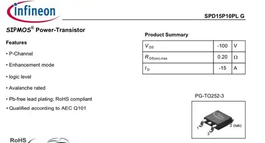

You say that because 10A of current is to be switched, N-channel is to be preferred. I don't see why. There are quite a few P-channel MOSFEts that can fulfill your requirements, as this search on DigiKey shows.
Just as an example, take the following model, taken from that list:
    This, except make sure you're inside the part's SOA. – Matt Young May 13 '17 at 23:24
  • @Matt young. there are some reasons for n channel to be preferred. 1. n channel usually has lower on resistance than P channel, since the switch will be always on during load working to dissipate power (and voltage drop as well) with high working current. 2. p channel has less choices on market than n channel, usually more expensive. – Spark May 16 '17 at 04:52
  • @Spark Ok, for n.2 (but you must also weigh in the cost for your high-side N-channel mosfet gate driver). For n.1 you should consider your design target. .... – LorenzoDonati4Ukraine-OnStrike May 16 '17 at 13:36
  • @Spark ... If you want the absolutely lowest Rds(on) you'll need N-channel, but if a given P-channel MOSFET meets your goals AND it simplifies your design, you could be better off with the latter. BTW, since we are talking about switching applications, you could also parallel devices: not only this lowers equivalent Rds(on), but it increases current handling capability and helps spreading the heat dissipation among multiple devices, which in turn could make your thermal design easier. – LorenzoDonati4Ukraine-OnStrike May 16 '17 at 13:36
  • @Spark Neither of those arguments are very good. You're going to have to add complexity to just turn the thing on. Whatever pennies you might have saved are going to be added back in spades. – Matt Young May 16 '17 at 14:09
    With 200mΩ RDSon you're going to be dissipating 20W at 10A. That's like having half a soldering iron on your board. – jcoffland Jul 23 '20 at 05:32
  • @jcoffland That MOSFET was just an example, not an optimized choice. Anyway, that Rds(on) value is a max value. If you browse the datasheet you'll see that typical value at 10A is around 140mohms for -10V Vgs drive. That makes still 14W, but the OP didn't specify which kind of switching app he is after. If the duty cycle is small the average dissipated power could be way smaller. – LorenzoDonati4Ukraine-OnStrike Jul 23 '20 at 18:14
