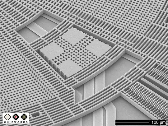

You are right, in a sense. These sensors do need moving components. However, they are a chip on your board.
Tiltsensors (actually, accelerometers), and gyroscopes (and pressuresensors, ...) are part of a family called MEMS: Micro-electromechanical systems.
Using similar techniques as already common in integrated circuit fabrication, we can make amazing little devices. We use the same processes of etching away things, depositing new layers, growing structures, etc.

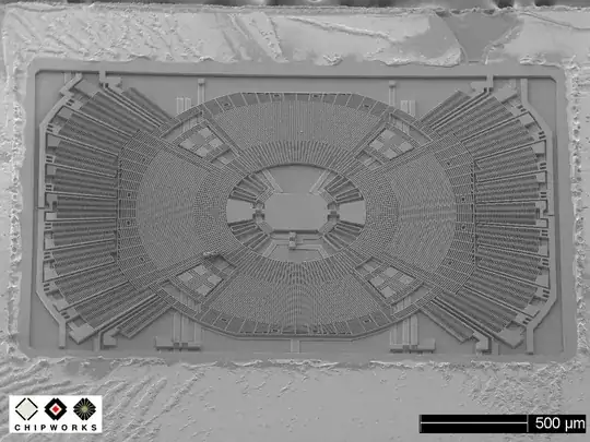

These are incredibly tiny devices. this is an example of a gyroscope:
link to the original website.
Most of these work by sensing changes in capacitance. A gyro would sense the changes due to rotation (the big thing in the picture would twist around the center axis. This will bring the tiny teeth that are interleaved closer together, and increase capacitance. Accelerometers work under a similar principle. These teeth can be spotted in the rightbottom corner of the second image.

    The mass of such sensor is incredibly low, thus there is no inertia slowing the sensing down. An iPhone is able the determine the RPM of an engine up to 3000 RPM using these sensors. incredible. – Jeroen3 May 11 '17 at 14:16

    Could you explain how what we are looking at is a gyroscope? I thought a gyroscope has to have something spinning around, but I can't spot what part of that spins... – GreenAsJade May 11 '17 at 14:48
    @Jeroen, how does one read an iPhone when it is spinning at 3000rpm? – Octopus May 11 '17 at 15:47
    @Octopus You wouldn't attach the phone to a rotating part and sense rotation with a gyro (obviously a bad idea). You would place the phone against the engine block and use the accelerometer to pick up vibration, analyze it to get the fundamental frequency and print out the equivalent RPM. – jms May 11 '17 at 16:43
    Gyroscopes are not angular accelerometers- they drive (vibrate) the wheel around the axis and measure the tilt of the wheel. – Spehro Pefhany May 11 '17 at 16:43
    @Octopus You don't. You simply touch the phone chassis to the motor. And run this app. – Jeroen3 May 11 '17 at 17:52

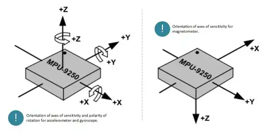

All the comments and answers are great to help you understand how it is possible. But, here's something that will help you understand how it's actualized in real products.
Orientation(image source)
This is a tiny IC (3x3x1 mm) by InvenSense. It has a three-axis accelerometer (for lateral movement), a three-axis gyroscope (for rotation), and a three-axis magnetometer (like a compass needle). It has internal code which will do all the complicated math. It consumes very little power.
This is only an example. There are several companies making similar products. Some are more accurate than others, some are cheaper, most don't have the magnetometer, etc...

Regarding how gyros/accels work in phones, you can easily google the APIs for these on the two platforms (example).
Note however that all OSs as of writing, in practice wrap the lower-level gyro/accel functions in some sort of convenient higher-level motion manager:
Accels/gyros, are in fact wrapped together at the OS level

Gyros were introduced to phones about 2010; accels were in them from the start.
A French/Italian company called STMicroelectronics pretty much makes most of the gyros for both apple and samsung.
Regarding accelerometers, most phones now have a couple of them since it works better that way. I have heard that there is more variety of suppliers of accelerometers (Bosch, etc).
You can literally buy MEMS gyros or accels, if for example you are making an electronic toy that includes such a feature.
Just to repeat, the fundamental quick answer to the question posed is
In "zero g", they retain (at a hardware level) the ability to detecting tilting, but they can no longer detect tilt.
