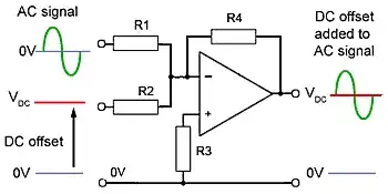

filo's anwser wont work if your ADC can't measure negative voltages. You could use a transformer or voltage divider, then use an opamp to add a DC value.enter image description here
In order to calculate AC power you just need to find a factor (constant) so you wont have trouble.
To find zero crossings you can use thresholds.

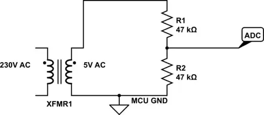

A transformer does not convert AC to DC (rectifier does that). Use a transformer to lower 230 VAC -> 5 VAC. Add a voltage divider (eg. 47k + 47k) across the secondary winding of the transformer. Connect one end of the divider to MCU ground and the center of the divider to your ADC pin (your MCU probably can measure only up to 3,3V). In this combination you will see your 230VAC as 2,5VAC referenced to MCU ground. You can measure that easily with ADC. When you are using a transformer you don't need another optocoupler.
schematic
Keep in mind that most optocouplers are non-linear, so if you want to measure voltage coming out from your current sensor you have to pick a linear optocoupler or map the characteristic and correct non-linearity in software.
Computing the exact power and power factor from voltage and current is yet another topic.

  • Thanks for your answer. It really explained a lot. For exact power, will it be okay if instead of measuring power factor, I increased my frequency(to calculate V&I) many times to that of AC mains or would that still give the wrong answer due to phase difference? – Zero_Cool May 10 '17 at 01:50
