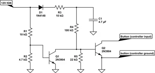

You need to generate a signal that activates for 500ms when power goes off, and something to keep your circuit powered during this time. These two functions could be combined in a circuit that looks something like this:-
schematic
When power is ON Q1 is turned on through R1, keeping Q2 off. When power is turned OFF C1 holds the voltage up (D1 preventing it from discharging into the power supply) while Q1 turns off allowing Q2 to turn on through R4. C1 then discharges slowly through R4 until Q2 turns off again.
R2 and R5 make Q1 and Q2 turn on/off at higher voltage for better defined switching points. R3 slows down the voltage rise on C1 when power applied to make sure Q1 turns on before Q2 is able to.
To avoid unwanted and possibly damaging ground loop currents you should connect your circuit's ground to the seat controller ground only, which hopefully is on one side of the button. If the button is not grounded then you may have to use some other method of shorting across it (eg. analog switch or opto-coupler).

  • This makes sense. I believe their wont be a ground on the buttons as the switches only complete the circuit allowing the current to flow to the memory module, location unknown, that in turn would move the seat position. I think if I can locate memory module I will have easy access to recommended ground. – Max May 12 '17 at 04:25
